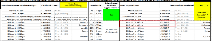

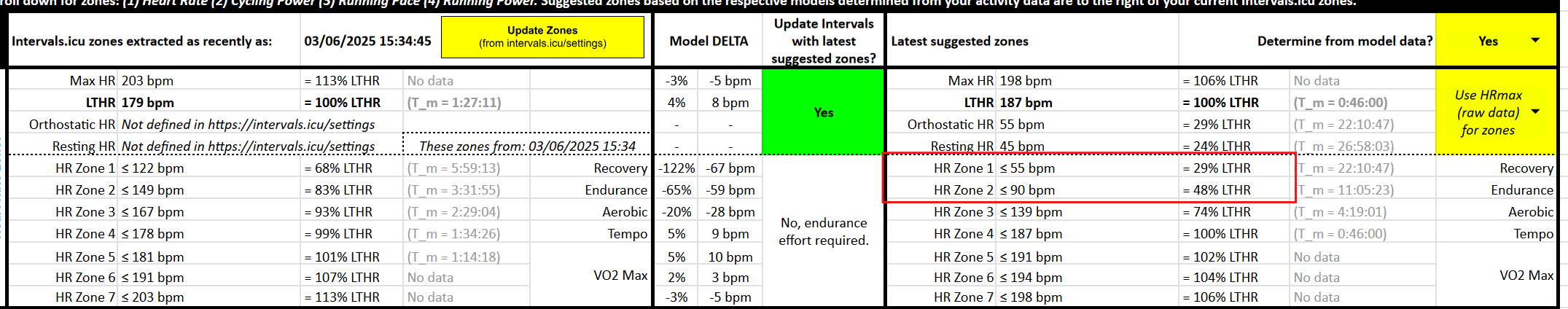

I followed the step by step setup and i end up with the sheet “Zones” not making sense… See picture :
I tried to understand where these estimations come from but I can’t figure it out..
Help..
