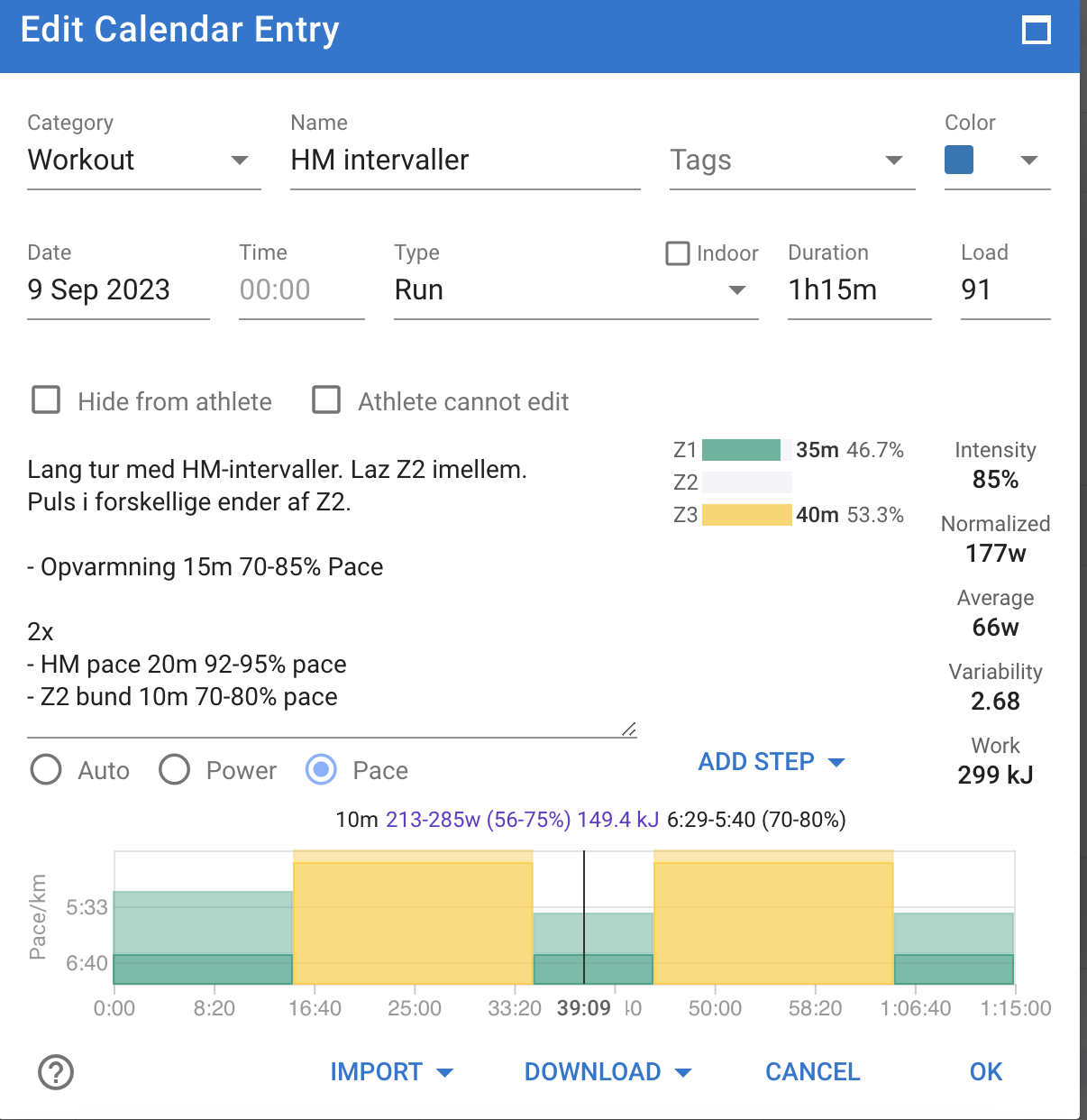

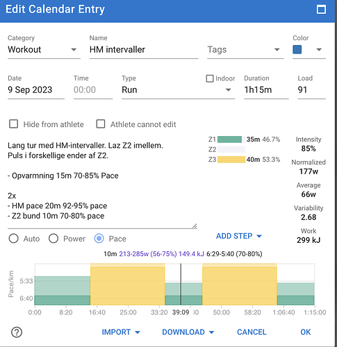

Bug on visualising workout
dosing on pace - which is showing in the descrition, but its power when showed graphically,
Have you set a threshold pace?
/Settings
I think Gerald is right. I created a similar workout for an athlete with threshold pace and pace zones set and it worked.
Also you should take out the “Z2” at the start of the 2nd step in the repeats. That is why you are getting power and pace offered. “Z2” on its own defaults to Z2 power.
I have yes - it was, as David pointed out because it reads Z2 as the intensity, and is set to read power pr default. I changed it to Zone2 and it came out as intended :muscle:
Thanks David!
It was because it reads Z2 as the intensity, and is set to read power pr default. I changed it to Zone 2 and it came out as intended :muscle:
