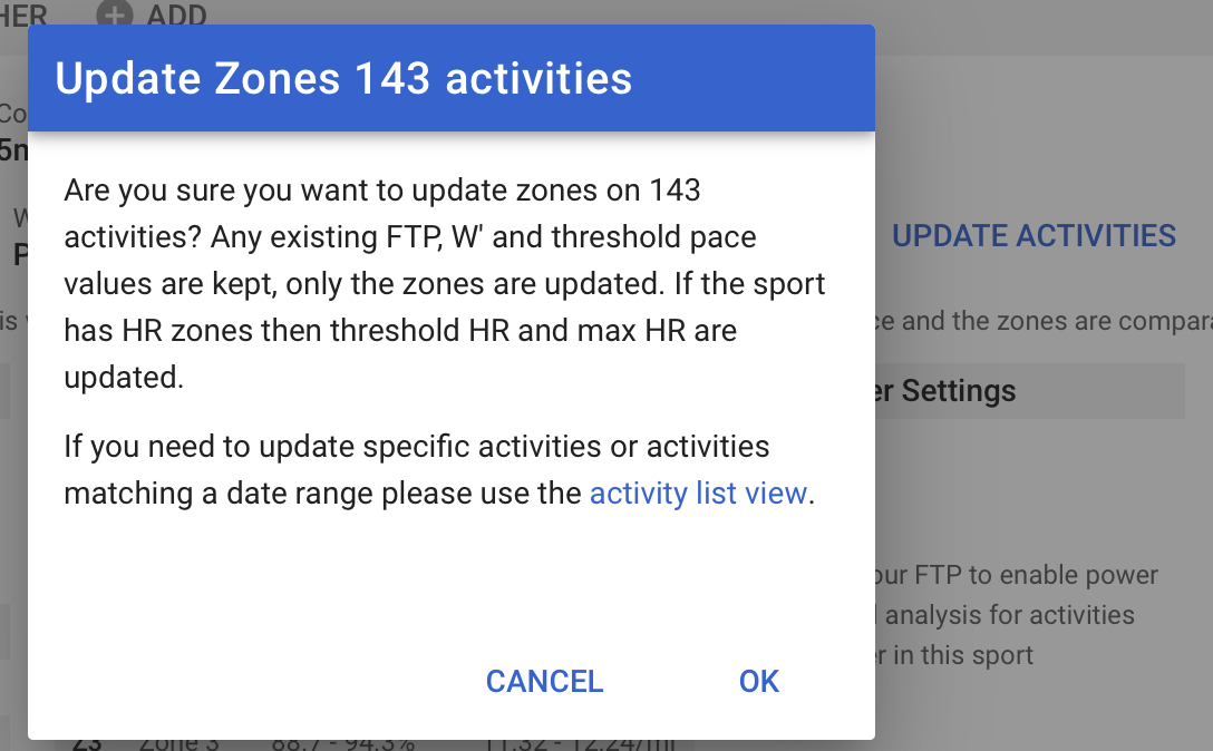

Went and reset all my thresholds and updated all activities. Still a bug, applying wrong threshold.

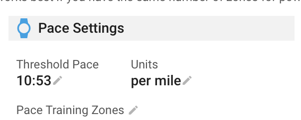

Corrected my pace to 10:53/mi:
Updated activities:

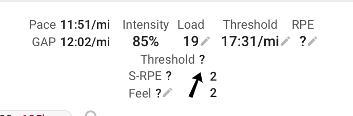

Now it’s applying the threshold of 10:53 as though it is my kilometer pace, converting it to 17:31/mi in the workouts. (10:53/mi = 17:31/km)

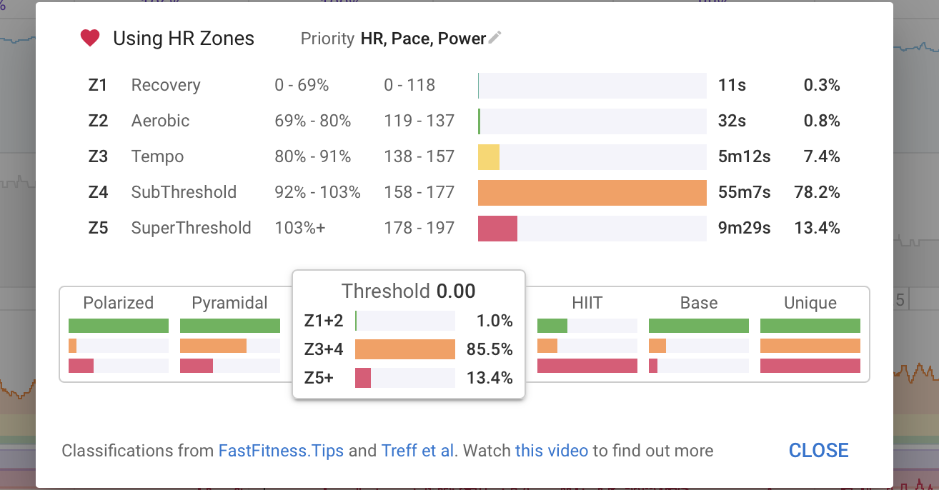

That threshold there relates to something else, that zone distribution of that particular session
In my case HR based, but could be power or pace based
