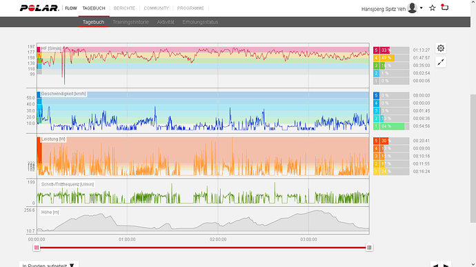

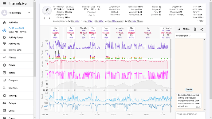

I have just imported all my activities from Polar Flow, and some of the activity data were like completely lost after some point, as in the attached images (near the end of the activity). When I delete the broken activity and upload it with .tcx file, one by one, everything looks fine. Is there any way to fix this? Well, I have hundreds of activities to upload.

I seem to understand what happened. In some activities (I haven’t checked all), Power, heart rate, and cadence recording stops as I pause recording, but somehow the GPS speed and altitude, which were from my Polar V800, keep being recorded until I stop the session, and thus those extra tail of data. As you can see from those images, the distance was 27.58km, but the data recorded was around 28.5km.
