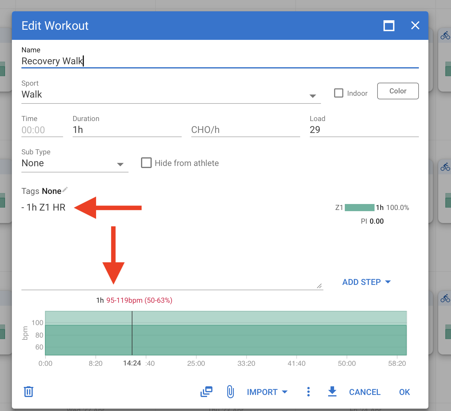

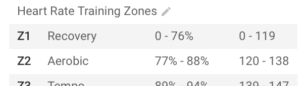

I’m new to this platform, so sorry if this is a n00b question, but…
Why does “Z1 HR” result in “95-119bpm”? Shouldn’t it be “0-119?”
Why is the bottom of Z1 50% of Max HR? Is that a setting we can tweak?
I know I could type in the HR range values manually, but that’s not ideal because when HR zones change the workouts won’t automatically update.
Any help would be very much appreciated. Thanks!

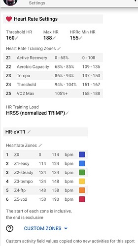

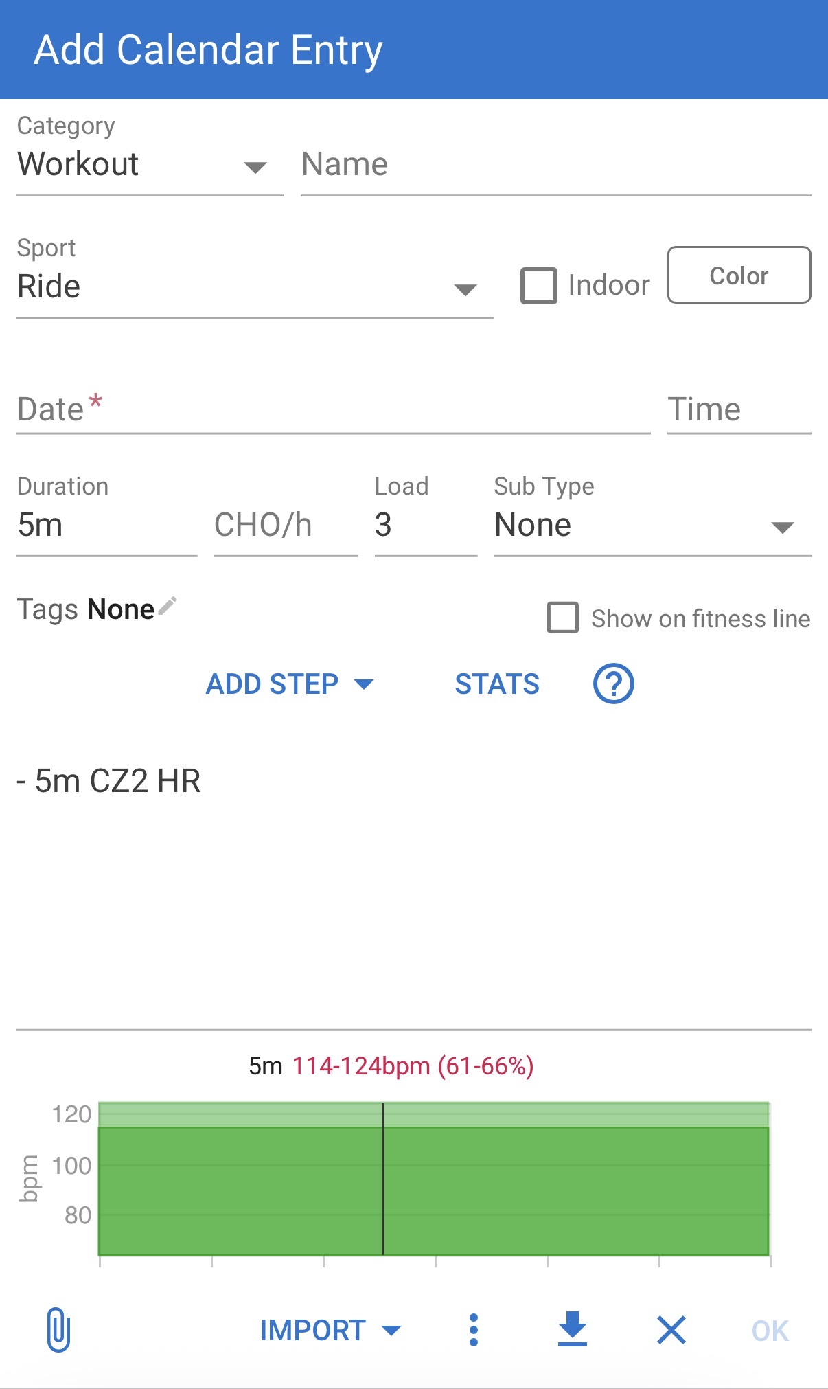

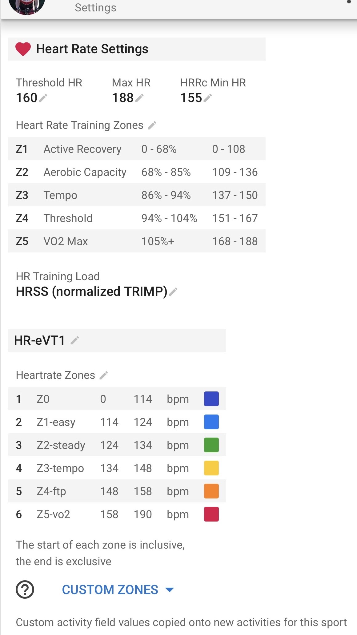

Make custom zones like this
And use them when creating a workout
