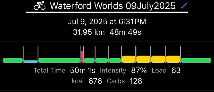

On each activity in the Calendar View there is a simplified intervals display with color-coded bands. I’m calling this the Mini Workout Chart. It would be great if in the Activity itself this was able to be viewed / exported in a larger size.
For example, here is the chart for a recent race I did that I wanted to share a summary of with friends. But I felt this was more like a thumbnail and I wanted something easier to see. I found a work-around in that the intervals.icu companion iOS app shows it bigger so I took an image from there, but it would have been nice to pull straight from browser.
Message I sent my friend to accompany it: My Power Profile last night - Green, Blue, Green was chilling in the B’s - Red Spike to establish the break, Green waiting for the A’s, then yellow pushing after they got a prime lap and finally gave me some space.

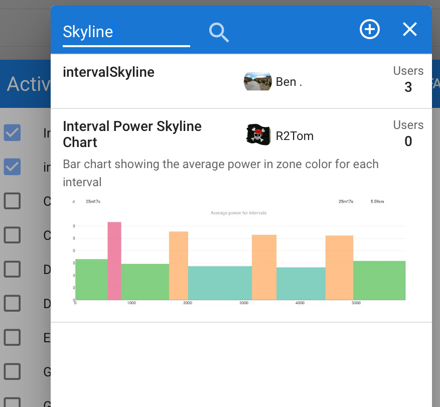

It’s called the Activity Skyline Chart Apparently. And in finding that I found that this was already loosely requested as a feature long ago. I checked Custom Charts and while there is a Skyline as FTP%, it is far from what I was looking for. I’d be very happy if this was shown in the charts stack, or as a scalable pop-up like the map. It is generally a good representation of the intervals, so I could imagine that it could even replace the current interval highlighting in the future @eva

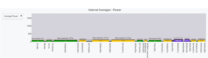

This one may come close but probably needs some attention to scale properly
The wide range for the highest power level (6 or 7) is what makes this chart difficult to view. Would be nice if it could show the highest power recorded plus about 10-20%; my lack of coding skills limits me from trying.
And there are better ones apparently
Ahh, I didn’t realize I need to look in Activity Charts instead of just Charts. Thanks!
