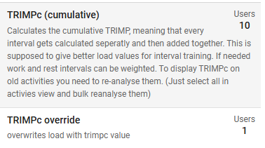

I added a custom activity field, if anyone wants to try it.

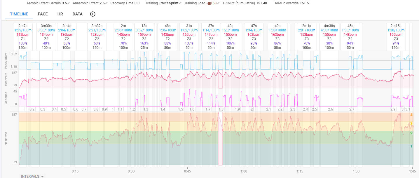

Hey again. Where do i find your custom activity field? (TRIMPc)? I see what you mean about the average HR being meaningless when it coumts the rest betweens intervals too. Need to exclude rests and only have the calculation done on actual sets

To use go to the “custom” activity fields (left of the camera icon) in your last swim and search for one of those two:
TRIMPc (cumulative) adds a field on top, that shows you the load number calculated by this method.
TRIMPc override, overrides your normal load. You won’t have the normal TRIMP anymore, and it will show in your graphs too.
! Carefull: The calculated numbers of TRIMPc are usually higher. This means if you are a triathlete or someone that does mutliple sports, use it for everything or have an inconsistent chart.

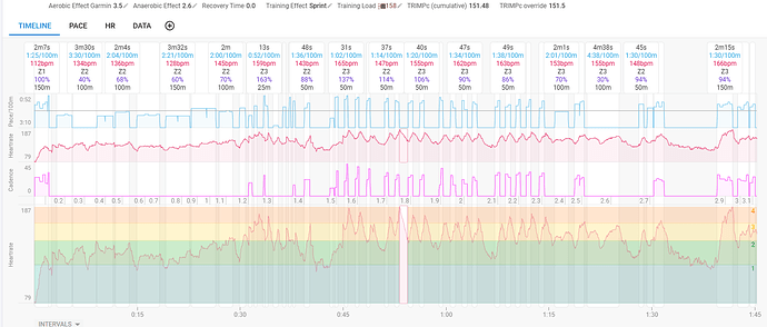

Other things to be aware of. You need to have auto-intervals activated with your watch.
Your intervals activity should look like this:
If you do not have the intervals mapped out like this, it will just be like the normal TRIMP
Please do not exclude the rest intervals. Heartrate spikes after some time, and in some training methods (like RST) they are incredibly important for the calculation.
