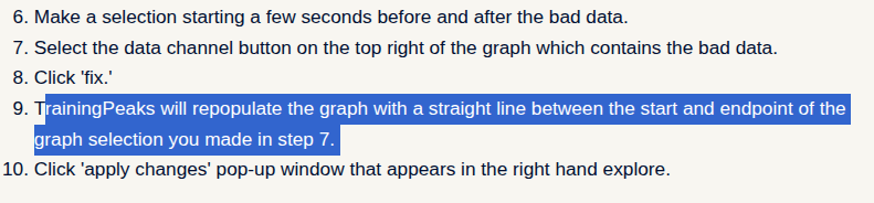

Would be nice to have one more option, something like an “auto rectification”, just as Training Peaks does.
It’s even easier and practical:
