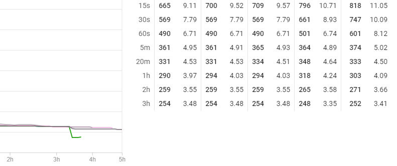

I cannot seem to add anything over 3 hours in best efforts on power, is this a feature?
Bug. It seems the best efforts table only goes out as far as the shortest of the power curves displayed. If you turn of 42 days then the 4h will probably show up. I will fix this tm.
it does show if you turn off days - thanks
The is fixed now. Tx for the report.
I’m having a similar issue and don’t know why… I can’t add 2h, 3h, or 4h to my best efforts.
Reading through this thread and thinking the website won’t let me add those unless I’ve got rides that are at least that long (which wouldn’t make sense to me, but hey), I’ve tried not showing the 42/84/90-day curves, just this season and last season so I know I’ve got rides to show that are at least that long. But even then, no joy.
Am I doing something wrong (just typing “2h” and pressing Enter) or is this a bug?
Thats a bug. Current you need to enter “120m” to get 2h.
I have just fixed it. Now you can enter “2h”. Reload the app to get the fix.
Yup, worked perfectly: added 2h, 3h, and 4h just now. Thank you!
