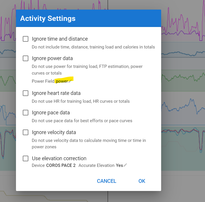

It doesn’t matter for Intervals. You can define which Power field you want to display by default in the Actions - Settings dialog.
Then create a Custom stream to define the Tacx Power stream if you want to display that too. If you don’t need the Tacx Power in Intervals, you’re done by simply setting the default power stream to the one coming from the Favero’s.

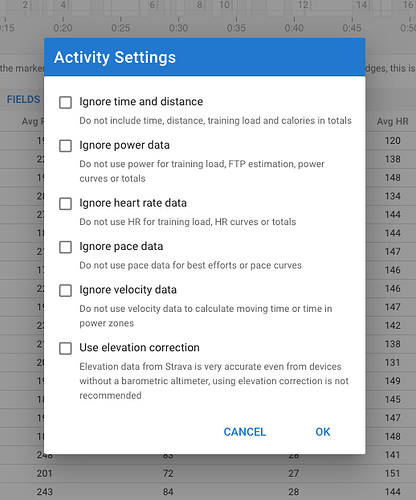

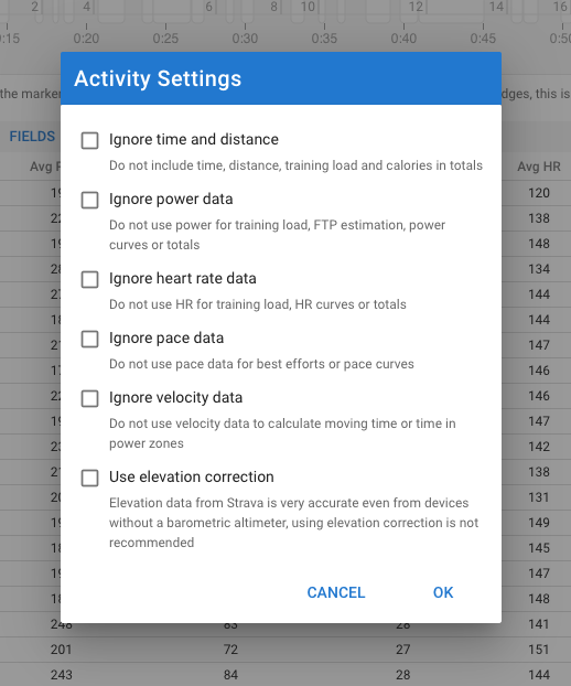

I do not see the power field choice on the Activity Settings pop-up.
I see you are getting your indieVelo activities from Strava. You should connect indieVelo directly to Intervals.icu. You can do this in Profile → Connected Accounts. Tick the “Upload rides” box. You can keep Strava connected. Intervals.icu will de-dup.
Then you will have both power traces.
Ah ha! I deleted all of the indieVelo activities that came in via Strava, and I uploaded all of the originals from the Windows PC where I run indieVelo. Now, I get the L/R balance and the choice of ‘Power Field.’
