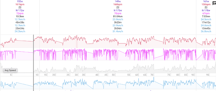

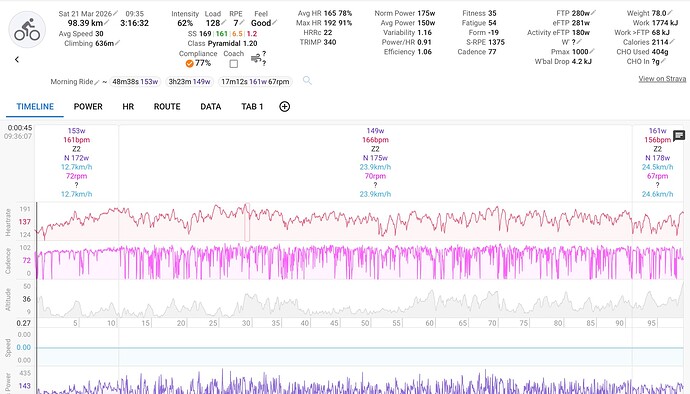

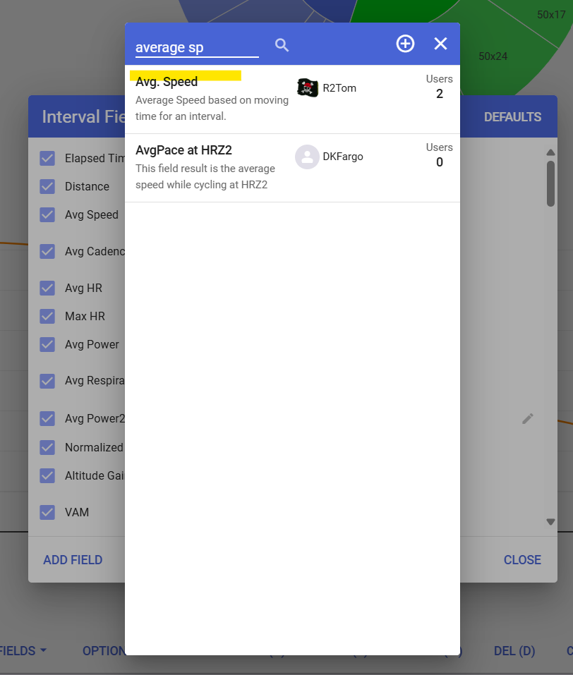

Can anyone help me to understand how to get the average speeds based on the ride time and NOT the elapsed time?
In the top you can see the average speed at 30kmh which is based on moving time and not elapsed time. I want my intervals to be based on moving time and not elapsed time. How can I fix this?
Thanks in advance!
You can search the Custom Fields section for Avg Speed, I must have made one for Avg Speed with moving time.
Hi, I’ve tried using it but its still the same for some reason.
Just as with Power, speed is averaged over elapsed time for intervals, that’s by default.

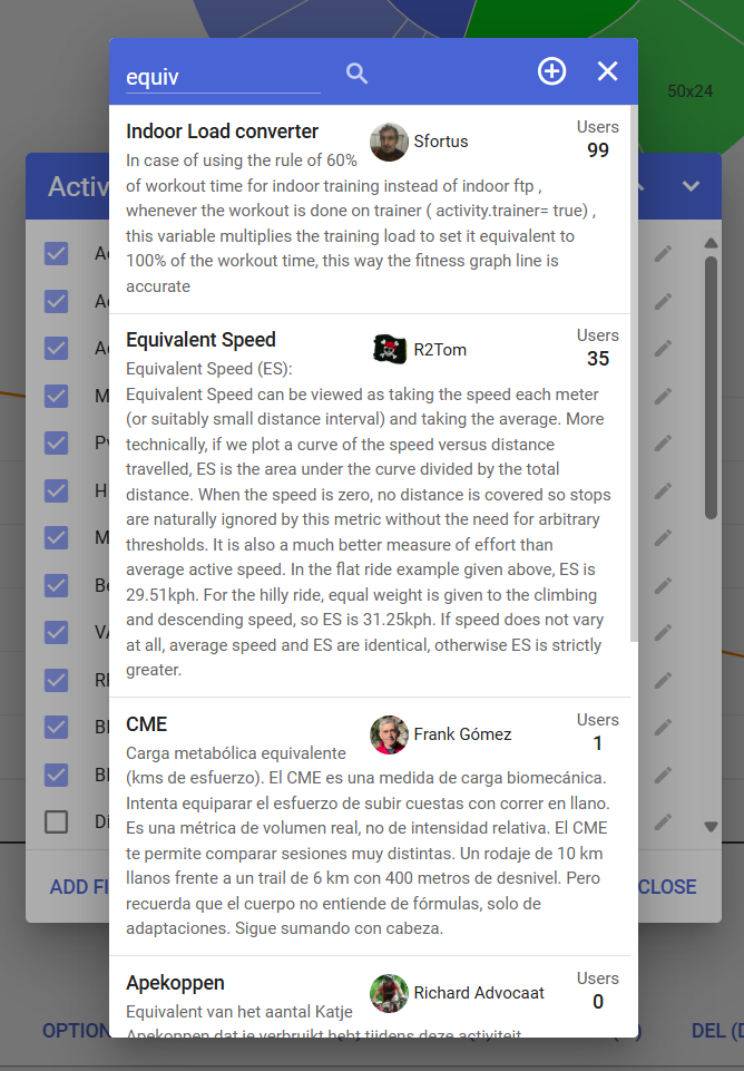

There are user created Custom fields to give you Avg speed for Moving time or even a Equivalent speed which calculates an average per distance covered. That last one is a speed averaged over distance and is a much more valid speed metric. Who cares about an average speed influenced by lots of climbing/descending? Equivalent speed takes that in consideration.
For intervals speed averaged over moving time, use this:
For Equivalent speed over the entire activity use:
Ok, I understand. I’ve tried to use the ā€˜ā€˜average speed’’ field but it’ still not working. The Equivalent speed is not visible to me. Any thoughts to why it’s like this? There are no issues when looking at the same activity in Strava or Garmin.
For intervals, elapsed time is unfortunally the same as moving time

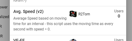

You can use v2 instead, which calculates the ā€œMoving TImeā€ as every second above 0 km/h.
That one seemed to do the trick for me! Thank you for the help. Really appreciate it!
