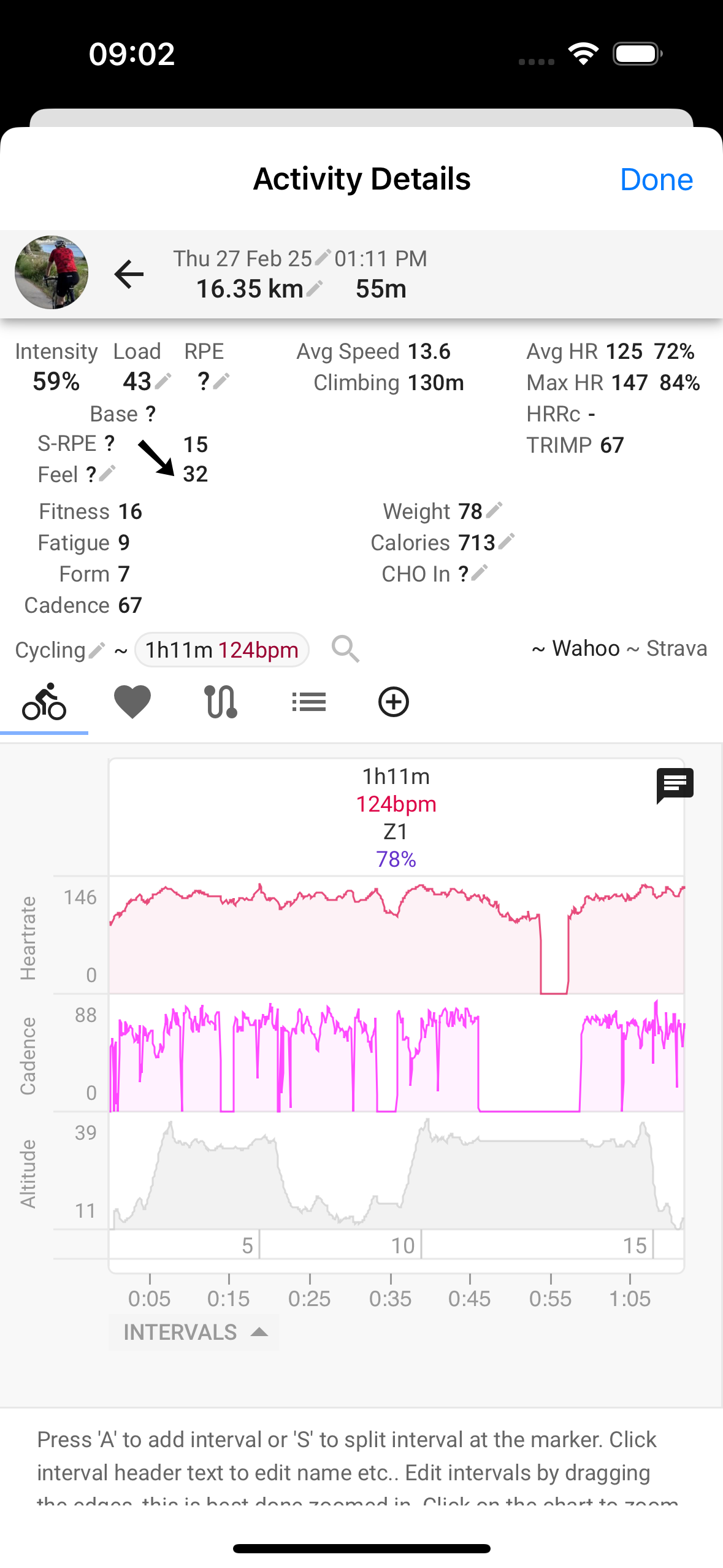

Average speed calculation incorrect from Wahoo
Yesterday I rode for 16.35 km with a ride time of 0:55:48. The elapsed time was 1:11:58 and intervals is showing the average speed as 13.6km/h which is based on the elapsed time and not the ride time.
This is the ride with data obtained from Wahoo (and Strava)
https://intervals.icu/activities/i67424421
Strava correctly shows the average speed as 17.7km/h
I’m pretty sure the average speed should be based on ride time not elapsed time.

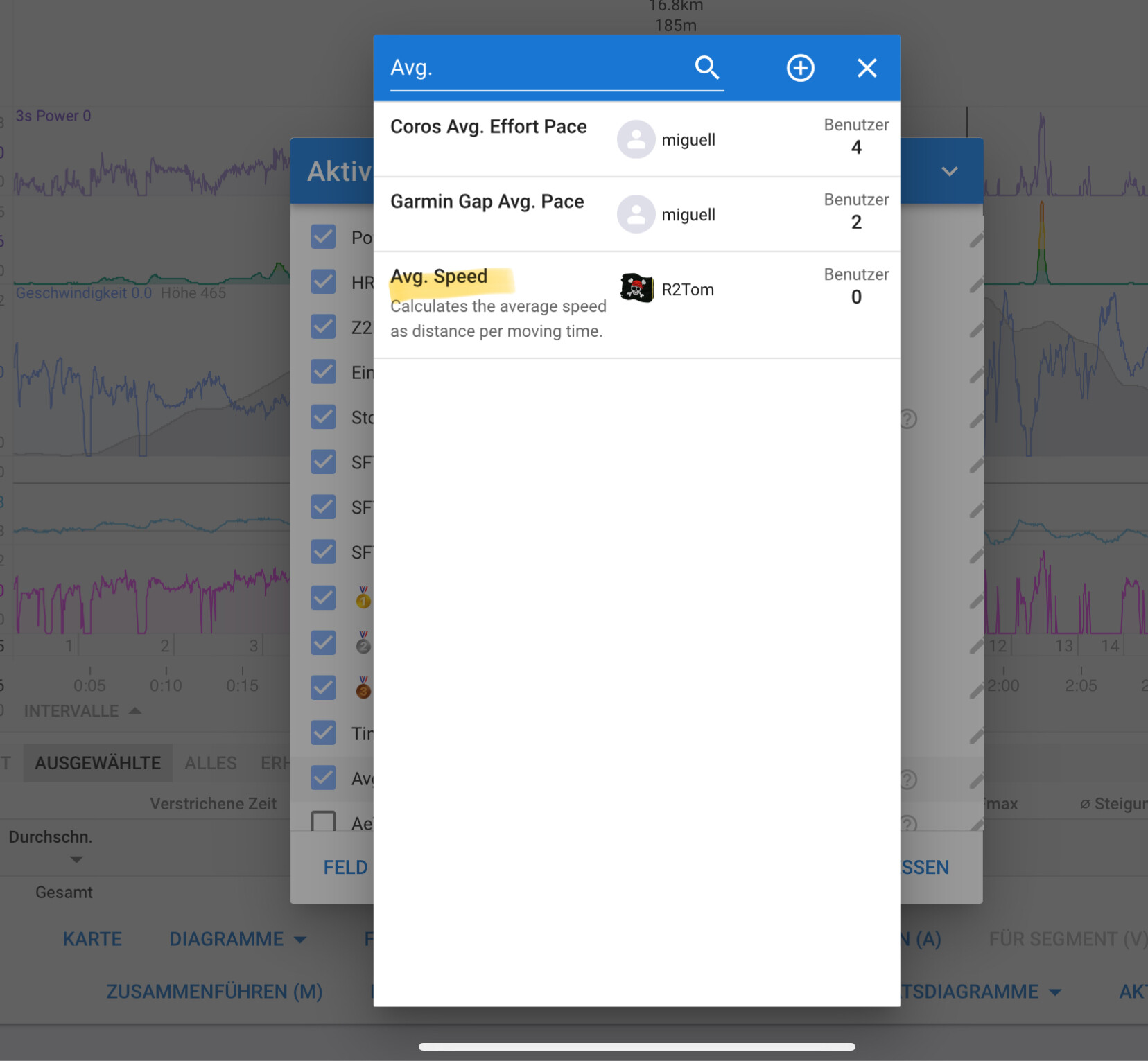

If you want it always like Strava, then just use/create a custom field. Create your own or use this by pressing Custom > Search Custom:
Thanks for the info. That’s really helpful Thanks
