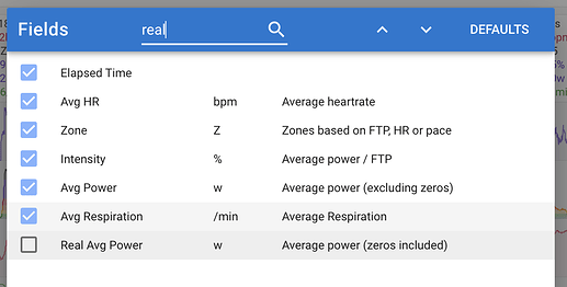

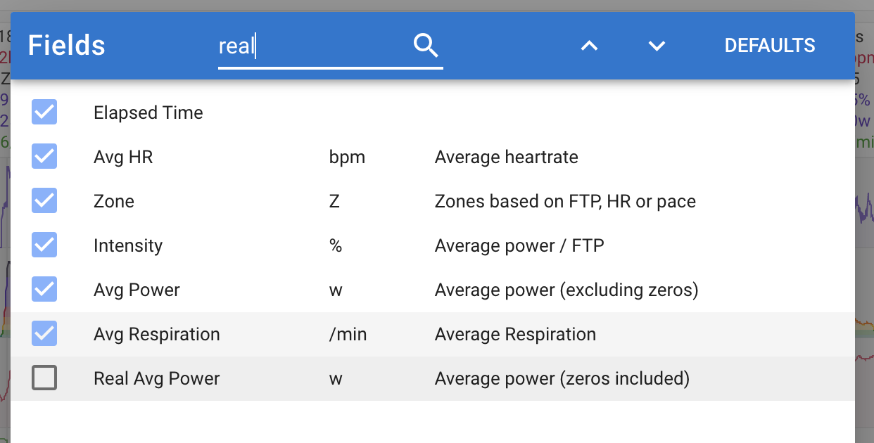

I had a look at this ride of yours: Intervals.icu
The avg power for an interval defaults to excluding zeros (assumed to be drop outs) and that 8m effort had a big zero in the middle (downhill it looks like). You can click “Fields” and choose “Real average power” to get a value with zeros included. I might well change the default to be that. Intervals.icu does support fixing drop-outs so not so much need to remove them.
thanks! David! awesome, I did not know that!!!
That appears to be a per-activity setting. Is there a global settings page for Fields that I’m missing?
It is “per sport” more or less.
I didn’t realize that if I changed the chart setting in an activity that it would affect all activities. I thought the change was local vs global. Cheers
Agreed. I’m starting to get a bit confused about what settings are global and which are local to the activity.
