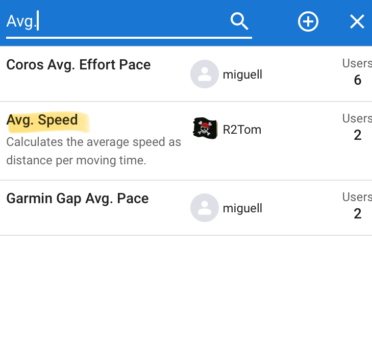

Therefore I created my own custom field ā€˜Avg. Speed’:
IMG_1681
It calculates distance / moving_time
I’ve edited the summary layout and using the custom field instead of the default value.

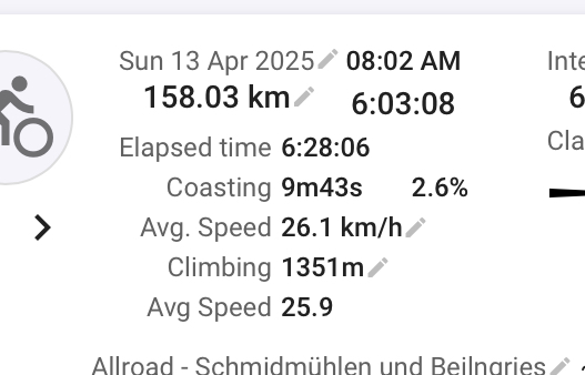

No, it doesn’t. In my example it was 6h28m elapsed time and 158km. That would be 158/6,5=24,3 km/h. But the default field shows 25.9 (the bottom value), my calculation shows 26.1 (distance/moving_time):
Now I’m completely lost :flushed:
@MedTechCD I am not 100% sure, but now I think you are partly correct. I think it uses something like ā€œrecorded timeā€ (= elapsed - not recorded time). So if you do never ever press pause, it is distance/elapsed_time. That is also true for most of my rides, regardless of stops at signs etc.
But for long rides I usually press the pause button for longer breaks, so it is not anymore elapsed time. If I subtract the pause time, these calculations would match my assumption. But it’s just a guess.

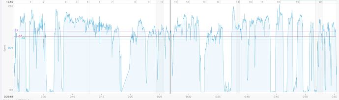

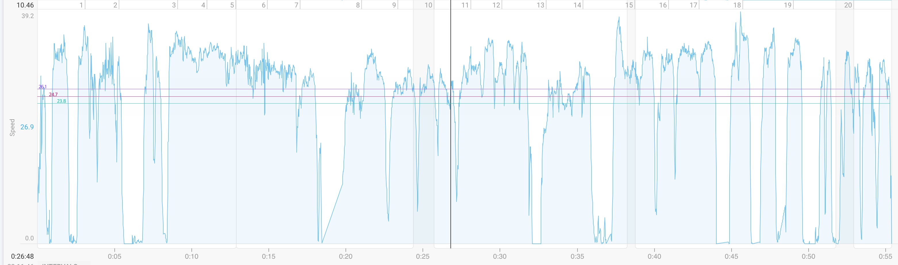

Here’s how the average look against the effort:
It’s subjective at the end of the day, but seems closer to expectations. For this same ride, ridewithgps shows 27.3 km/h. With an adjusted minimum speed of 8 km/h (instead of the 1 km/h above) we can also get 27.2 km/h here, which looks more like this:
