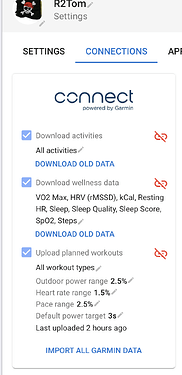

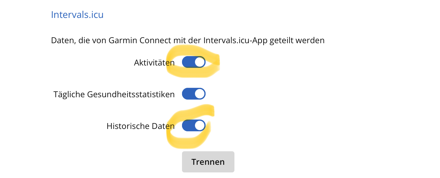

Then you are no connected. Please show a screenshot - it should look like that:
Check, that you didn‘t connect to the wrong account.

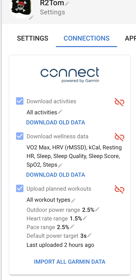

On Connect it should look like this:
If it doesn‘t look like this, disconnect via red buttons in intervals. Reconnect again, and be sure that you are logged in in the right accounts on intervals and garmin.

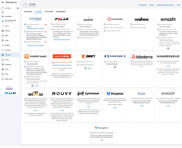

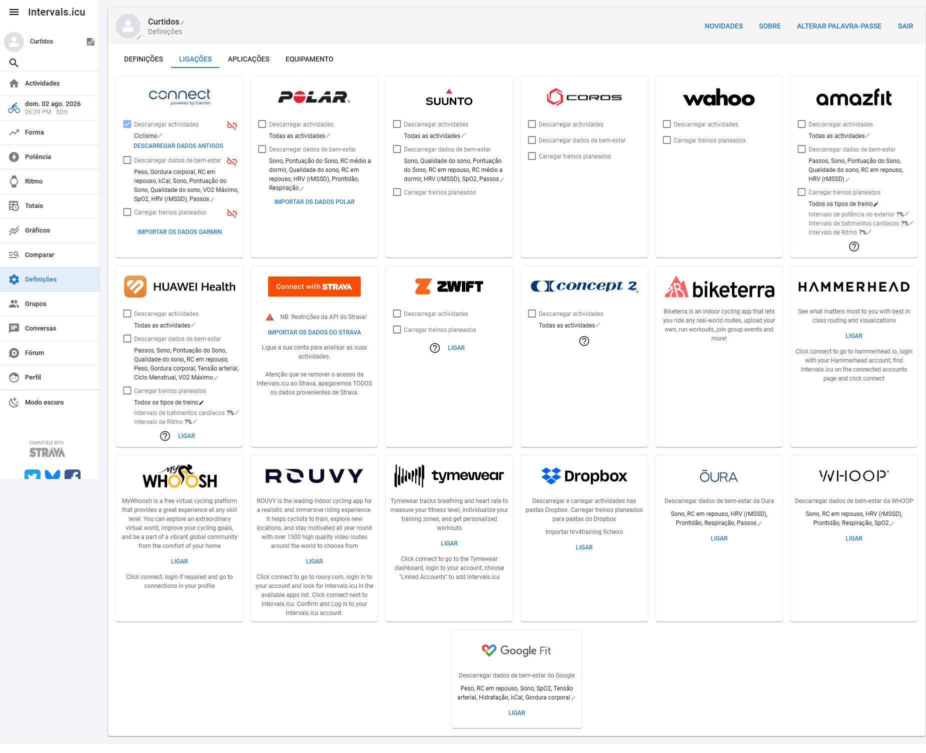

I have attached a screenshot of the Connections page after completing the authorization.
Could someone please check if my Garmin connection has actually been created on the server?

I attached the screenshot in my previous reply. Maybe it is still waiting for moderation.

Also, my Garmin Connections page does not look like yours. I don’t see the Garmin account or the Disconnect buttons.

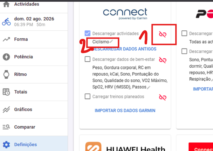

From your screenshot:
1 = the ‘Disconnect’ button
2 = Import filter
Best practice to reconnect to Garmin is to first use the disconnect button in Intervals, then reconnect from Intervals which will redirect you to authenticate on Garmin.

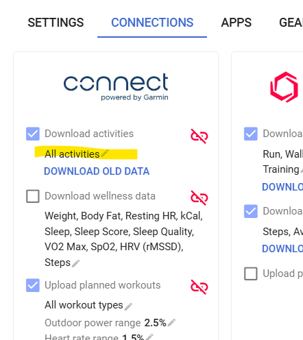

If you’re not exactly sure about the activity type, then make sure to not select any activity type. That will result in syncing All Activities.
