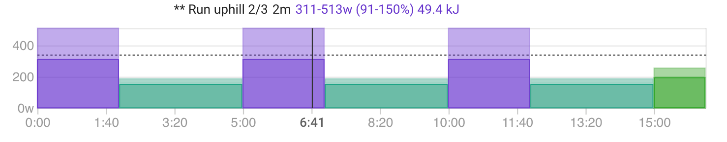

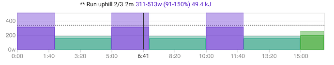

One is just, nest them hierarchically, and let the visual diagram inform the user as to how it works.
3x
* 4x
** Run uphill 2m Z4-Z6 (311-513w) power=3s intensity=interval
** Press Lap downhill 0.12mi 0.12mi Z2 (191-256w) intensity=recovery
* Rest 3m Z1 intensity=rest

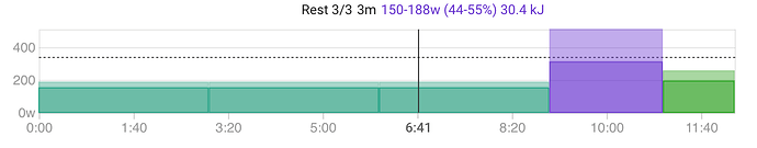

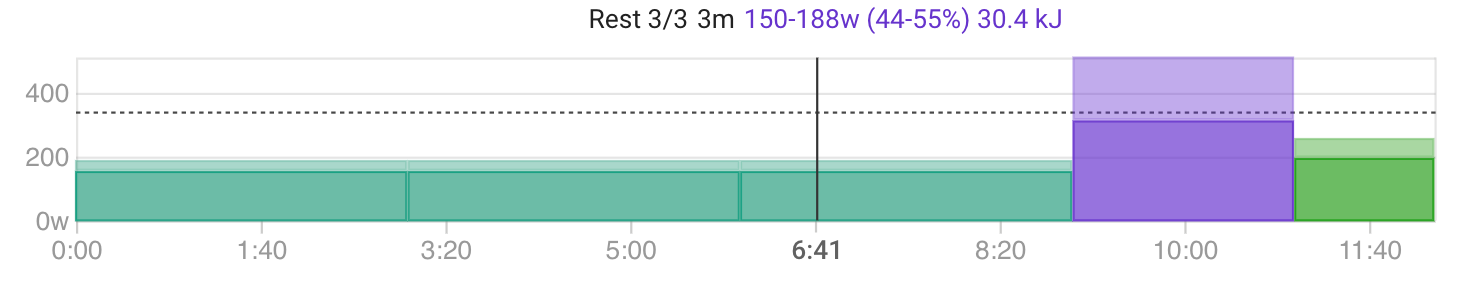

I should note that adding an additional layer of hierarchy currently has some unexpected behaviors.
and if I indent the 2m interval further like so
3x
* 4x
*** Run uphill 2m Z4-Z6 (311-513w) power=3s intensity=interval

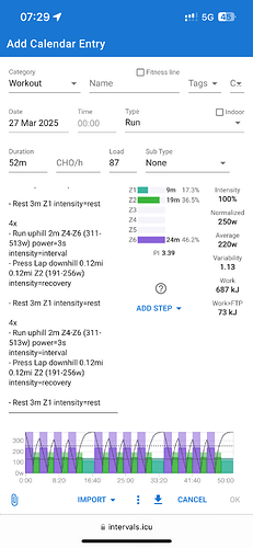

it renders this way, which I find totally curious.

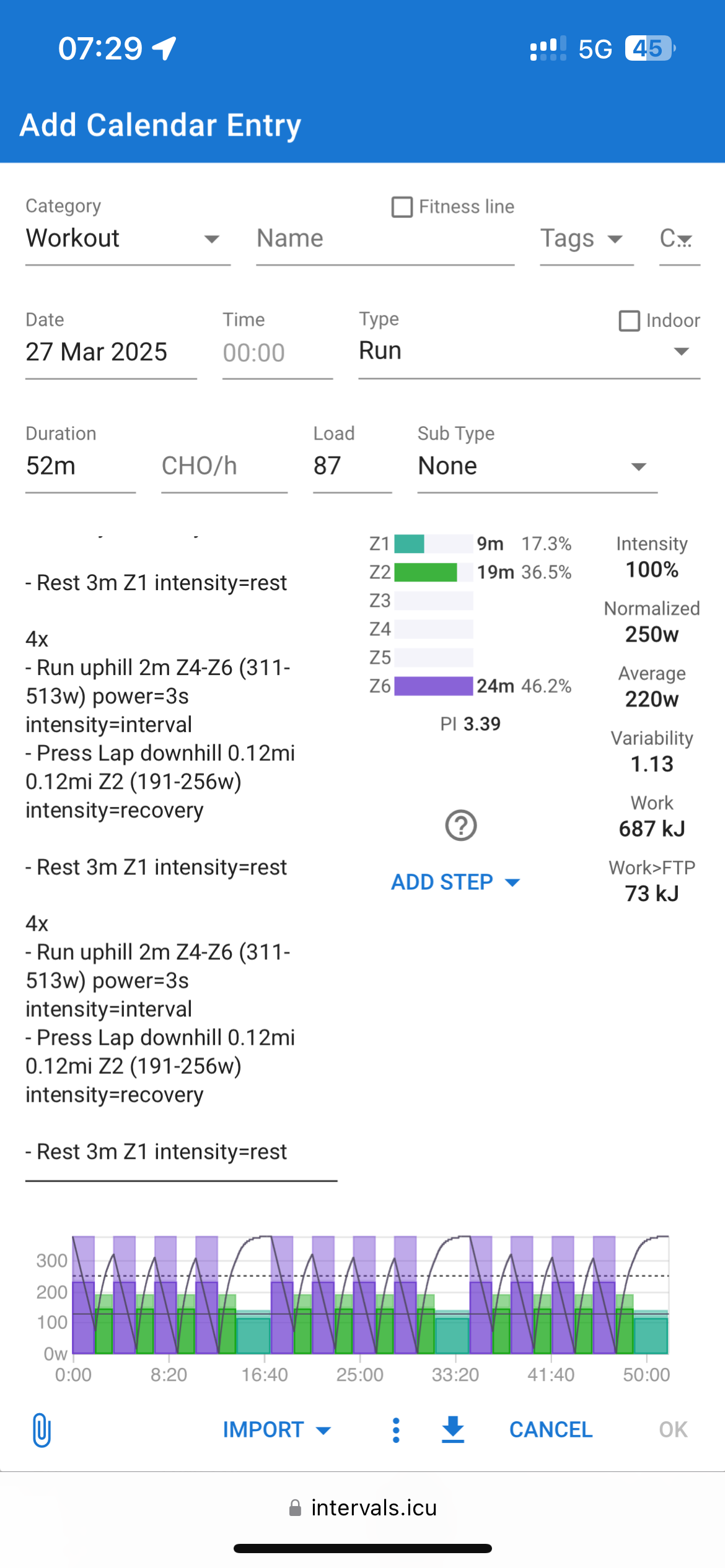

Nested loops are not supported at this moment. It has been asked before and might be on the todo list.
You can nest/group one set of intervals, currently, and then repeat the single nesting. There needs to be a space between the two nested intervals and the recovery between sets, then repeat::
4x
- Run uphill 2m Z4-Z6 (311-513w) power=3s intensity=interval
- Press Lap downhill 0.12mi 0.12mi Z2 (191-256w) intensity=recovery
- Rest 3m Z1 intensity=rest
4x
4x
@Gerald that’s exactly what I currently do. :+1:

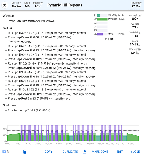

There are other edge cases like Ladders or Pyramids workouts that I of course expect to be particularly verbose.
This nonsense for example… an awesome workout that’s completely stupid to write out.
