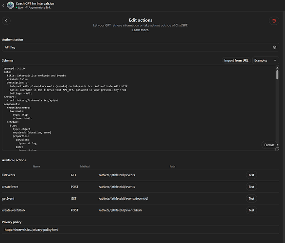

I’ve created a custom Coach GPT that uses ChatGPT’s new Actions feature. Now I can discuss my training plan with ChatGPT; once I’m happy with it, I simply tell it to send the workouts to Intervals.icu, which is synchronised with my Wahoo bike computer and watch. The sessions appear automatically, I complete them, and then analyse the results in Intervals.
Coach GPT can also pull in my past workouts, but because Intervals provides such rich logic and performance metrics, I prefer to analyse everything there instead of letting the AI crunch the numbers.
This is the schema I use in the custom action (don’t forget to change your athleteID and API key):

This is great! Probably a dumb question, where do I give my athlete ID? Just tell it inside the chat window? and api key within auth settings? Getting some 403 errors, and have tried to paste the Athlete ID in the chat, using Basic Auth with API_KEY as username and my key as the key
You can either hardcode the athlete id or tell it your athlete ID. Ideally the auth flow would use oauth.

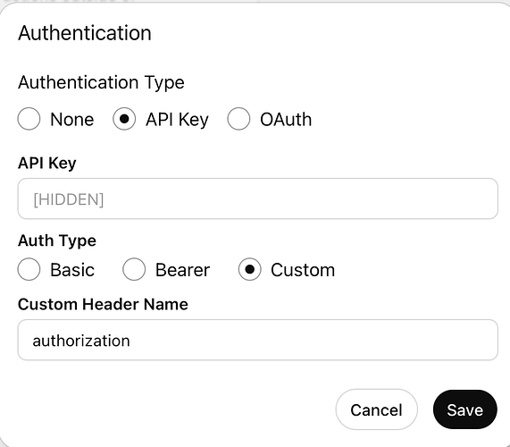

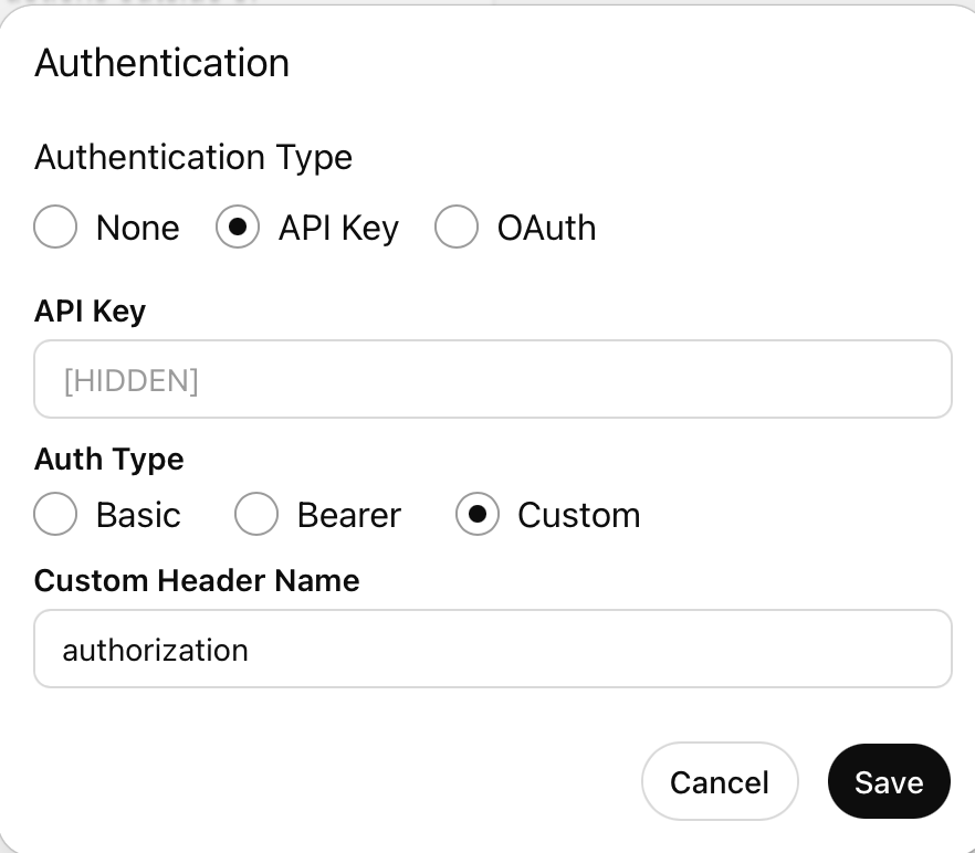

I couldn’t figure out the right values for auth so I used custom: “Authorization” as the header and then used “Basic: ” as the value
Yeah, I can test this correctly using basic auth of username: API_KEY and password of my key, but struggling to get it to work within the context of GPT actions. Any tips?
I then run curl -v -u API_KEY:<secret> https://intervals.icu/api/v1/athlete/<athleteId>/activities.csv 2>&1 | grep Authoriz
And I copy/paste the output, it’ll look like Basic <base64string> into the API Key field.
There’s probably an easier way to do it, but I couldn’t figure it out.

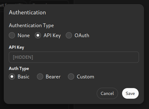

You have to set the Authentication to ‘API key’ and pick this settings.
As you can find in the documentation you need to set a base64 string of “API_KEY:{your api key from your settings page}”. You can do this ussing a tool like Cyberchef or bash/Powershell.

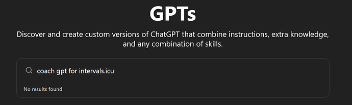

Where is this? If I search for it, I can’t find it.
