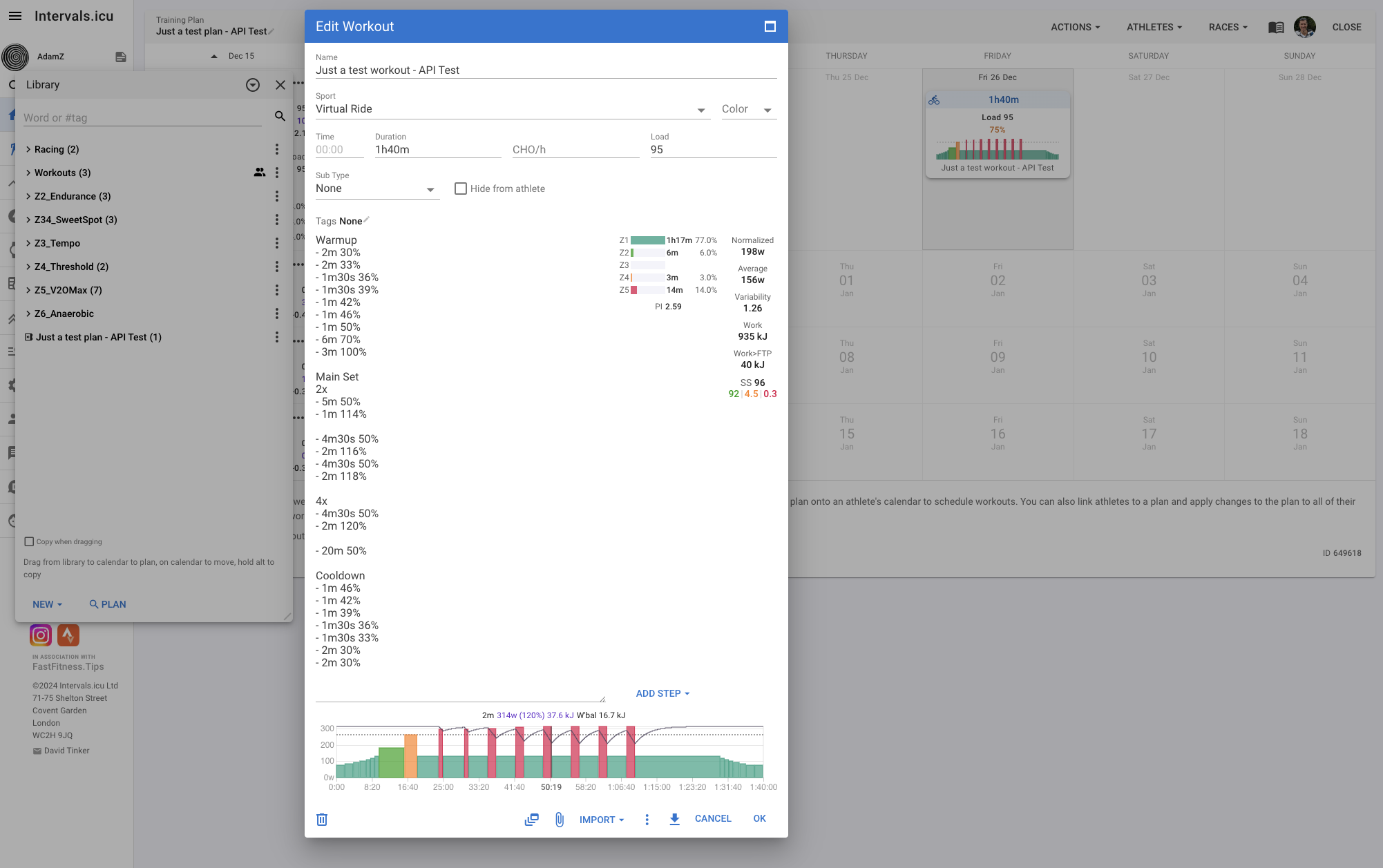

API-created library workout shows wrong workout structure (cached from old workout)
Summary:
When creating a workout in a library plan via the API (POST /api/v1/athlete/{id}/workouts), the workout structure displayed in the UI is incorrect. It appears to be cached/reused from a previously deleted workout, despite the API returning the correct description and calculated values.
Steps to Reproduce:
  1. Create a new plan folder via API: POST /api/v1/athlete/{id}/folders
  2. Create a workout in that folder via API: POST /api/v1/athlete/{id}/workouts with a simple description:
  "folder_id": 649610,
  "name": "Just a test workout - API Test",
  "day": 4,
  "description": "Just a test workout.\n\nWarmup\n- 2m 42%\n\nMain Set\n\n4x\n- 30s 120% 100rpm\n- 4m30s 68%\n\nCooldown\n- 1m 50%",
  "type": "VirtualRide"
  1. API returns success with the correct description echoed back:
  "id": 71817686,
  "moving_time": 6060,
  "icu_training_load": 95,
  1. Open the workout in the Intervals.icu UI
Expected Result:
Workout structure should match the description:
  • Warmup: 2m 42%
  • Main Set: 4x (30s 120% 100rpm, 4m30s 68%)
  • Cooldown: 1m 50%

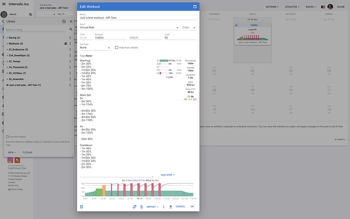

Actual Result:
Workout structure shows a completely different workout (see screenshot):
  • Warmup: 2m 30%, 2m 33%, 1m30s 36%, 1m30s 39%, 1m 42%, 1m 46%, 1m 50%, 6m 70%, 3m 100%
  • Main Set: 2x (5m 50%, 1m 114%), etc.
This structure is from an old workout I created weeks/months ago and have since deleted.
(see screenshot)
API Response:
Here is the complete response object.

Key Observation:
The API response contains the correct description that was sent, yet the UI displays a completely different workout structure. This suggests the workout steps are being retrieved from a cache or lookup that references old/deleted workout data, rather than being parsed from the description field.
Additional Details:
  • The plan name is correct: “Just a test plan - API Test”
  • The workout name is correct: “Just a test workout - API Test”
  • The duration (1h40m) and load (95) match the API response
  • The API response description field contains the correct text
  • But the rendered workout steps/structure are from an old deleted workout
Environment:
  • API endpoint: POST /api/v1/athlete/{id}/workouts
  • Workout created inside a plan folder (not as a calendar event)
Screenshot attached: Shows the workout editor with correct name but wrong workout structure.
ok, now it seems to be working correctly… I did not changed anything. In fact I tried it multiple times before posting here and the workout created contained in different runs different workout structures of past workouts…
