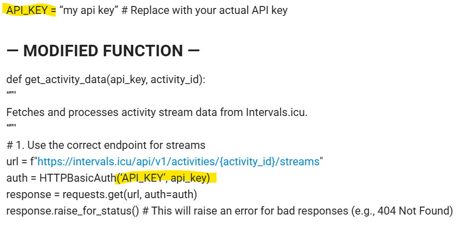

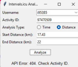

i have entered the right API key and also the activity id straight from the address bar of intervals. i even removed “i” but still got the same error:
API error 404: Check activity ID. is there something wrong with this?

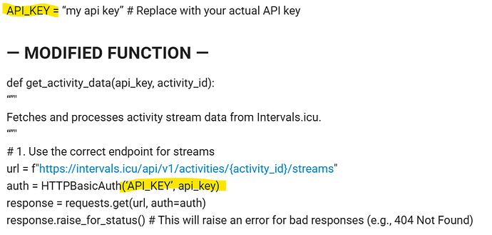

Something looks wrong with User/API_KEY combination
If you set the variable API_KEY (capitalized) to be your Intervals api-key, then the auth line a bit lower is wrong. The user for basic auth is “API_KEY” (capitalized).
The variable used should be api_key unless I’m completely not understanding.
The url must be
https://intervals.icu/api/v1/activity/{activity_id}/streams{ext}

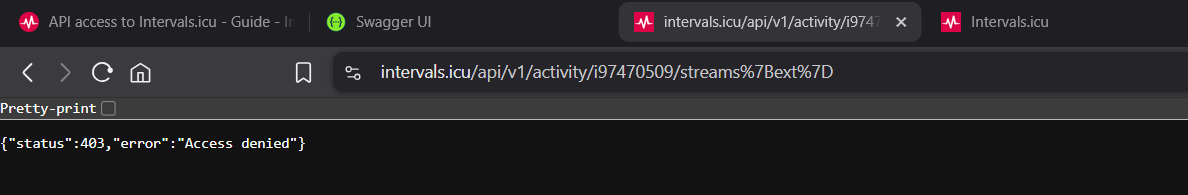

I am still getting the API error: 404. Check activity ID.
the activity ID is directly from my own activity. in this case it is i97470509
i used i97470509 and 97470509 but still the same 404 error. I hope im not asking too much to check on this please. I really appreciate your patience
This is what I get when using the address bar
That’s what I would expect because I don’t have access to your data.

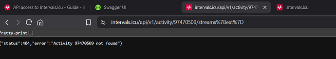

When I drop the leading ‘i’, I get this
Again what is to be expected because the Activity ID doesn’t exist
Something isn’t correct in the string composition if you ask my opinion.

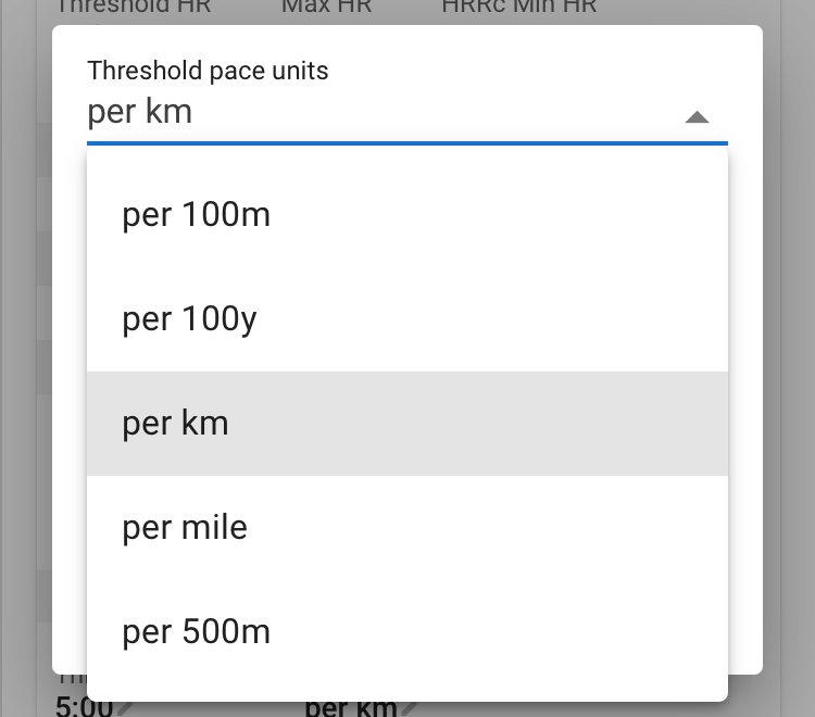

I am having a problem with the pace output. The query returns a number that is obviously in the format “m/s”. But the assigned unit is “MINS_KM”.
"threshold_pace": 3.4013605,
"pace_units": "MINS_KM"
The pace is therefore interpreted as 3:24 min/km and not as 4:54 min/km, which would actually be correct.
Is this due to a setting in intervals.icu (units) or is it an error in the API?
According to the API doc it seems to be the setting of the threshold pace unit. Not the unit of the returned value. This is always in m/s.
Hmm… but none of the units would match “m/s”. So there is no way that ChatGPT can interpret the correct pace from the JSON. Incidentally, this not only affects threshold pace, but apparently also the pace in workouts. How is everyone dealing with this?
As I said. The unit is always in SI units. So pace is always m/s. Always. Regardless of that option. It is meant for third party applications to do the correct conversion to the user defined unit.
You probably need to put something between Intervals.icu and ChatGPT to convert. The Intervals.icu back-end and API always uses m/s for speed, meters for distance, kg for weight and so on. Conversion to user specified units is done in the web app.
