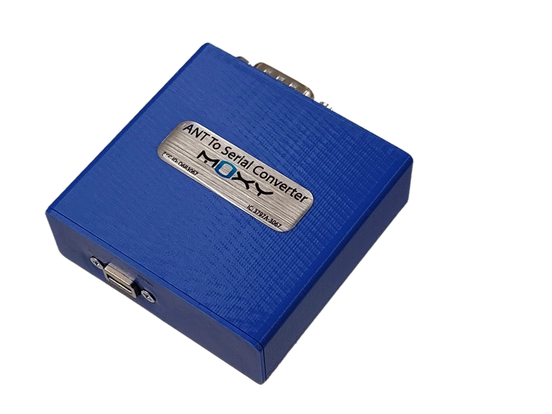

Moxy sells a serial adapter for $149USD that will do what you’re asking. It converts the data stream from several Ant+ device profiles for use in various software, e.g., Excel, Matlab, etc. You’ll likely need a serial port on your PC, unless Moxy has a serial to USB adapter. You’ll also have to prepare your own VBA code to read the device in Excel or find some other DAQ.
