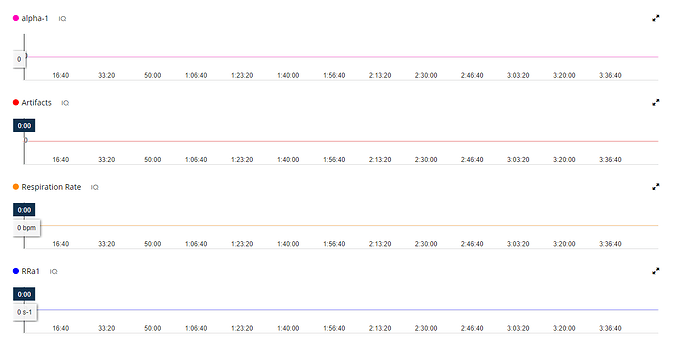

I did a little training this afternoon and ‘Ra’… started to display :slight_smile:
That is, @Inigo’s referring me to the “AlphaHRV” underpinnings description page and my subsequent dabbling on the subject and correlating the lack of “Ra” display with the Zwift - GarminConnect unpairing and re-pairing" was the cause.

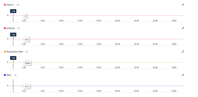

I’ve added the AlphaHRV on the running screen, bike screen etc. But nothing is stored during the training.
I’ve tried to remove all HRM sensors, add again, restart the edge, restart the fenix etc.

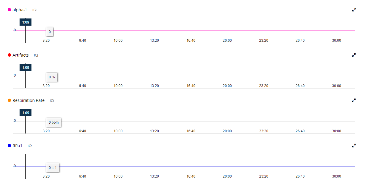

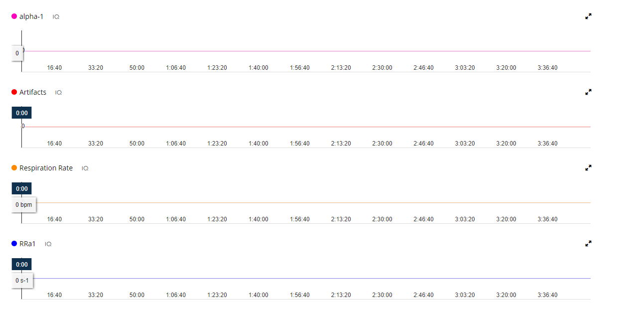

Per example, yesterday, on a bike training with my Garmin HRM and on the edge :
Then, on a running after the riding with my watch Fenix and the Garmin HRM, again 0.
In the two cases, Garmin HRM is connected with ANT+.

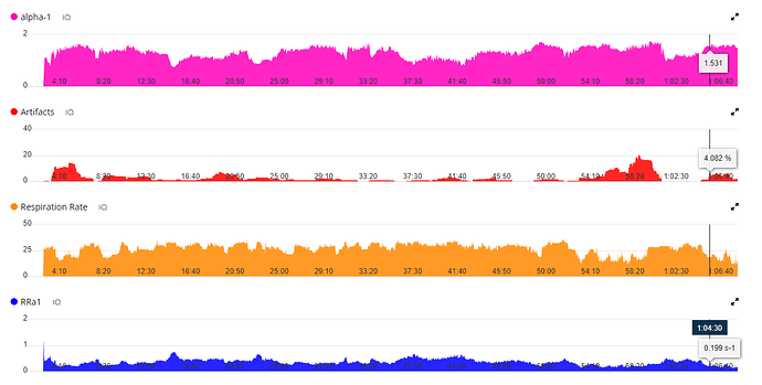

This morning, on a bike training, with my Fenix and a XOSS HRM in ANT+, i have values !!!
I will take a look on the return bike way and on the edge to see if AlphaHRV has stored datas.

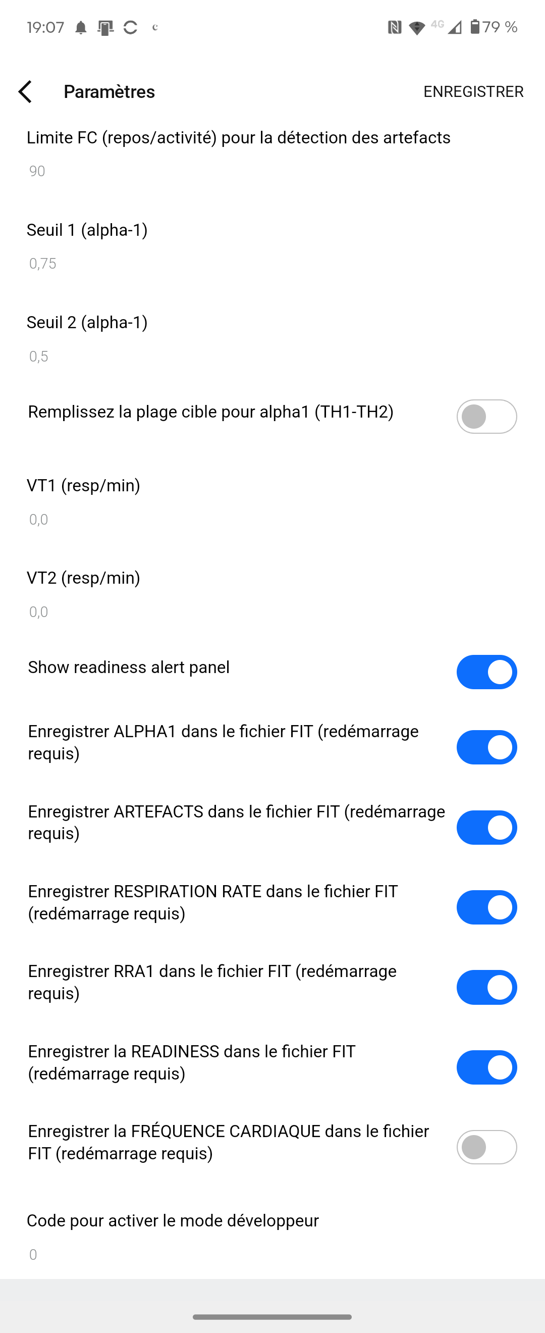

Did you set data recording on your edge to yes?
Also, what Edge are you using. 1020 and below may not work, AFAIK
It is a 1040 one.

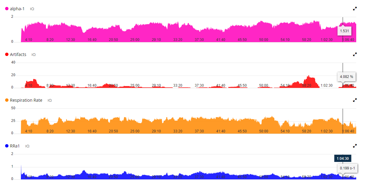

During the ride, i switch my Xoss HRM to BLE one. And it works.
When I switch to ANT+, no data.
What is the problem for me, is the HRM+ Garmin. With ANT+, I have no AlphaHRV datas on both equipment. Working on ANT+ with HRM Xoss one.

EDIT : yes, it is set on ON for all except frequency rate because it is already store.
On both equipment.

I set ANT+ for HRM+ this morning, the idea is to have both connexion on GPS and Fenix. And I set ONLY on my Fenix AlphaHRV on Bluetooth.
And it works perfectly :slight_smile:
