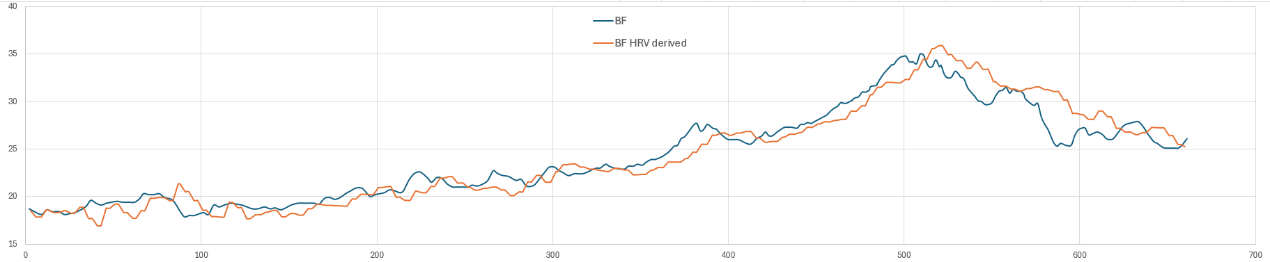

Can’t respond on TymeWear data, but underneath is a comparison of breathing frequency measured by a MET-cart during a VO2max test (in blue), and the breathing frequency derived from HRV by the AlphaHRV IQ field (in orange).
You can see that the HRV derived is trailing a bit, which is inevitable given the needed measurement window, but overall, I consider it surprisingly accurate.
x-axis is seconds.

Thanks for the data! Been after a comparison for ages!
I run AlphaHRV alongside Tymewear and the breathing rate numbers can be pretty far apart sometimes. I’ve not had a chance to graph them yet but maybe I can find a way..
