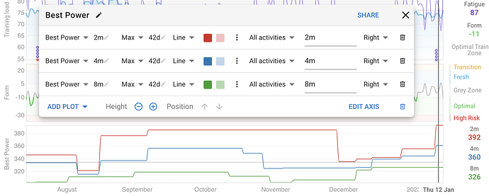

Those dots are baked onto the activities but you can add a custom chart to plot best power for the durations you are interested in:
Hi Gerald, think you want to check your charts again. You get a purple dot every time you hit a new PR for the season so I start with a full set at the beginning of the year and continue to collect new purple dots as the year progresses. It’d just be nice to see just the PRs over any time slot, including multiple years.
Hi David, ah makes sense. This is also what I did. Works well to keep track over specific durations. Just thought it’d be a nice to have.

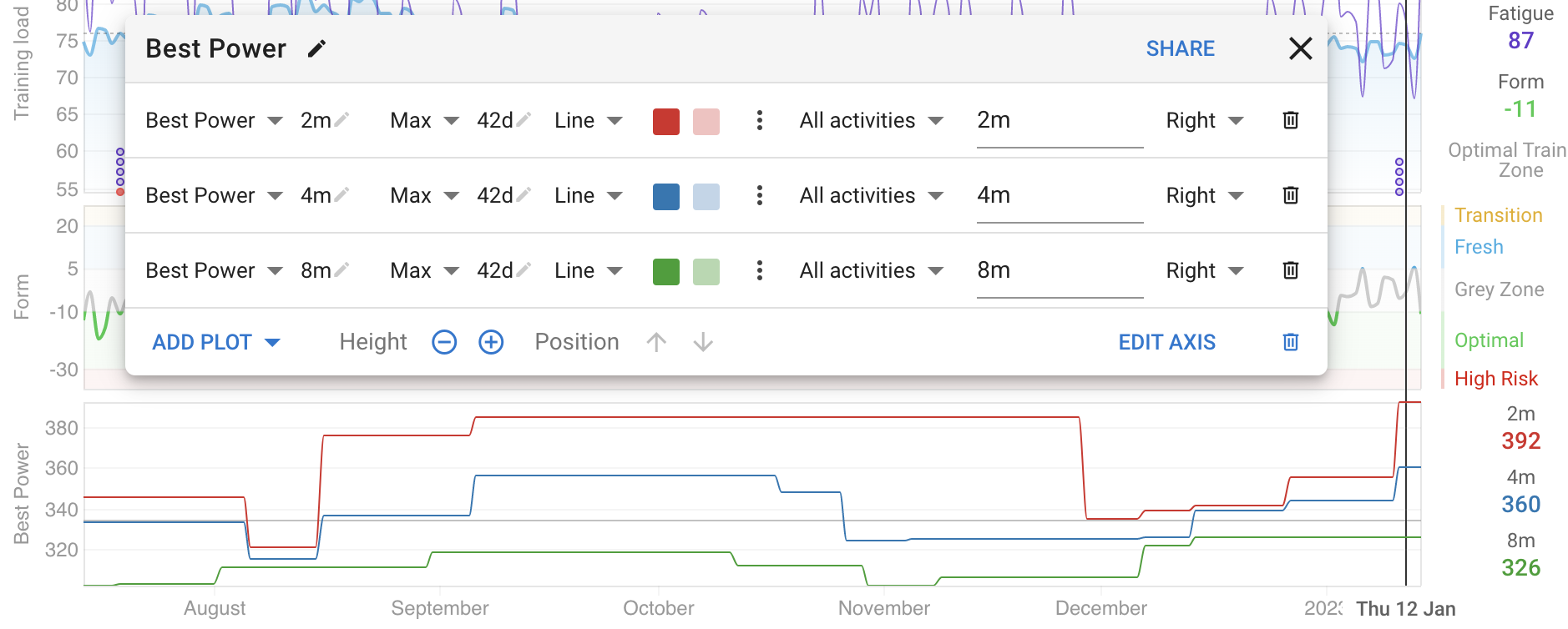

How would I set this chart to show max for all time power instead of 42 days?

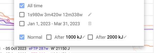

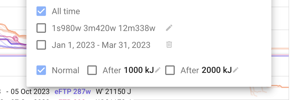

Click “Power Curves” and tick the “All Time” box:
