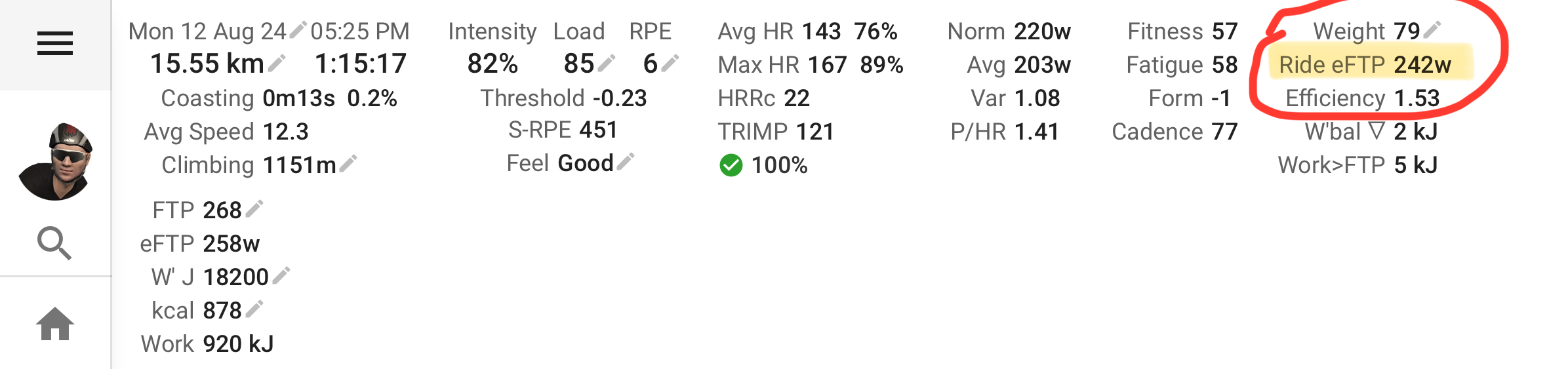

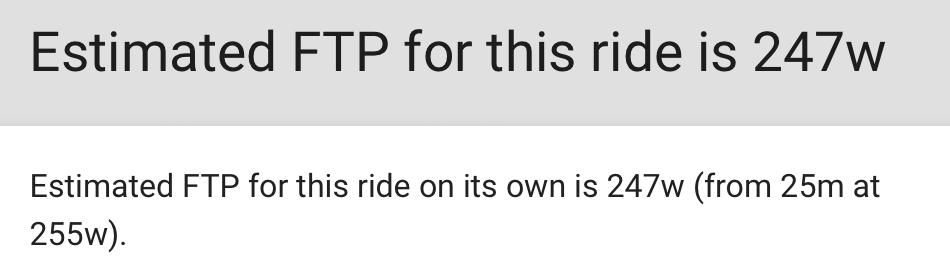

For the 325W that you refer to, is that in the field Ride eFTP on the activity header (top right of screen)?
That is different from your actual eFTP on the power and settings pages.
The eFTP is a modelled value based on your best effort; then used to create your power duration curve.

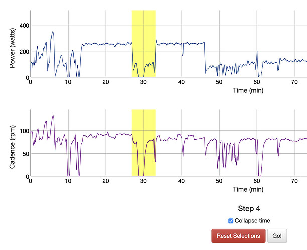

I took this 2x13-min threshold ride from earlier this year:
put into FitFileTools and removed the rest interval:

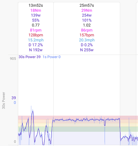

Uploaded to Intervals and got this new 1x26-min @ threshold:

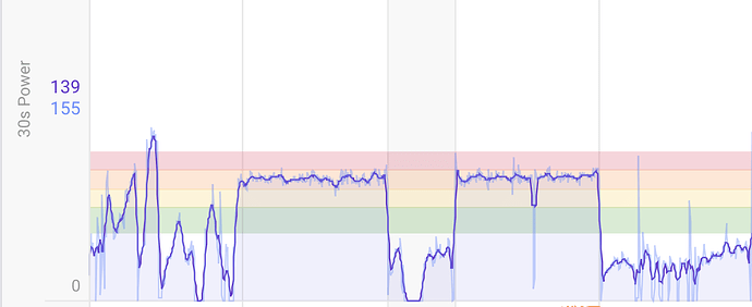

Before:

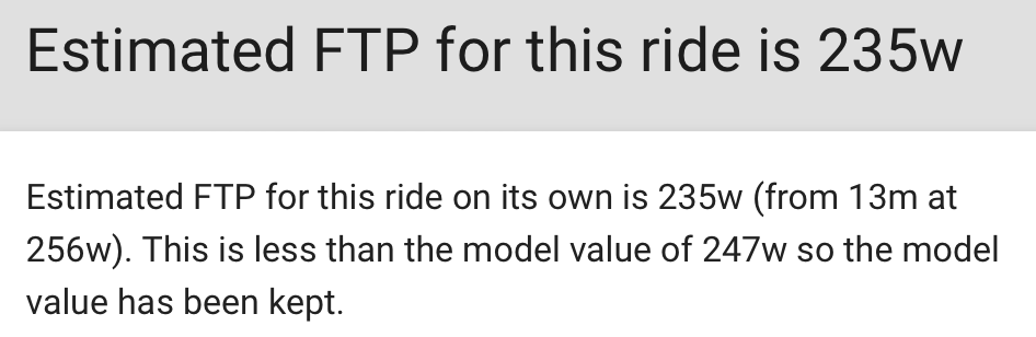

After:

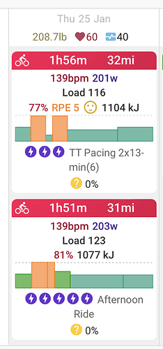

and calendar for 25 January 2024:

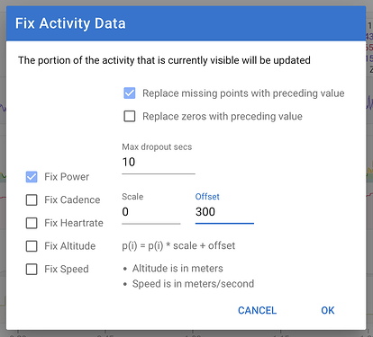

You can do that. You can zoom to the “rest” portion then do Actions → Fix data, fill in an offset to set the power:
To undo this you need to do Actions → Reprocess file.
Good info, easy to do and easy restore. Thank you!
