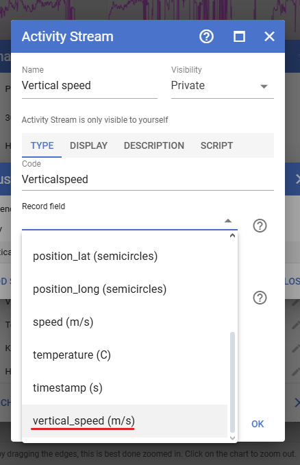

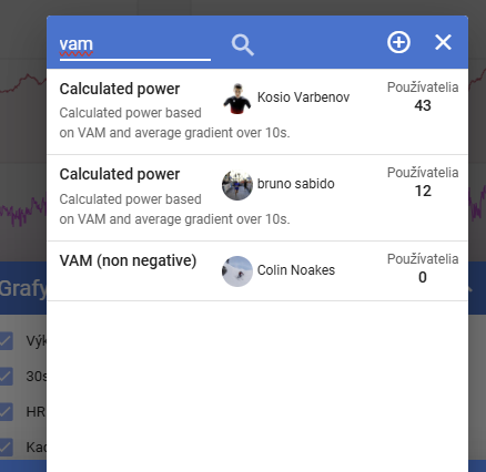

You can add the VAM stream chart (Charts → VAM)

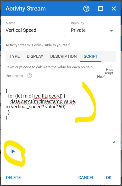

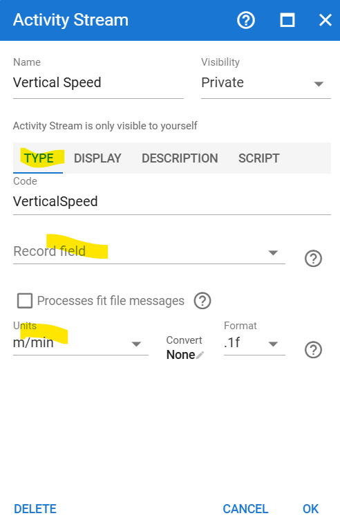

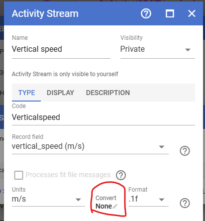

I allready created a custom stream for Vertical Speed. Garmin defined it in m/s. However you can create a script with *60 to get m/min values you want.
Yes, I tried it, but I could not find the name of the scripting parameter.
