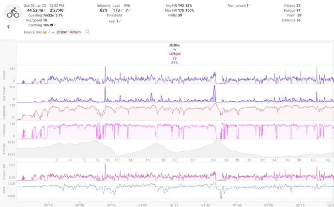

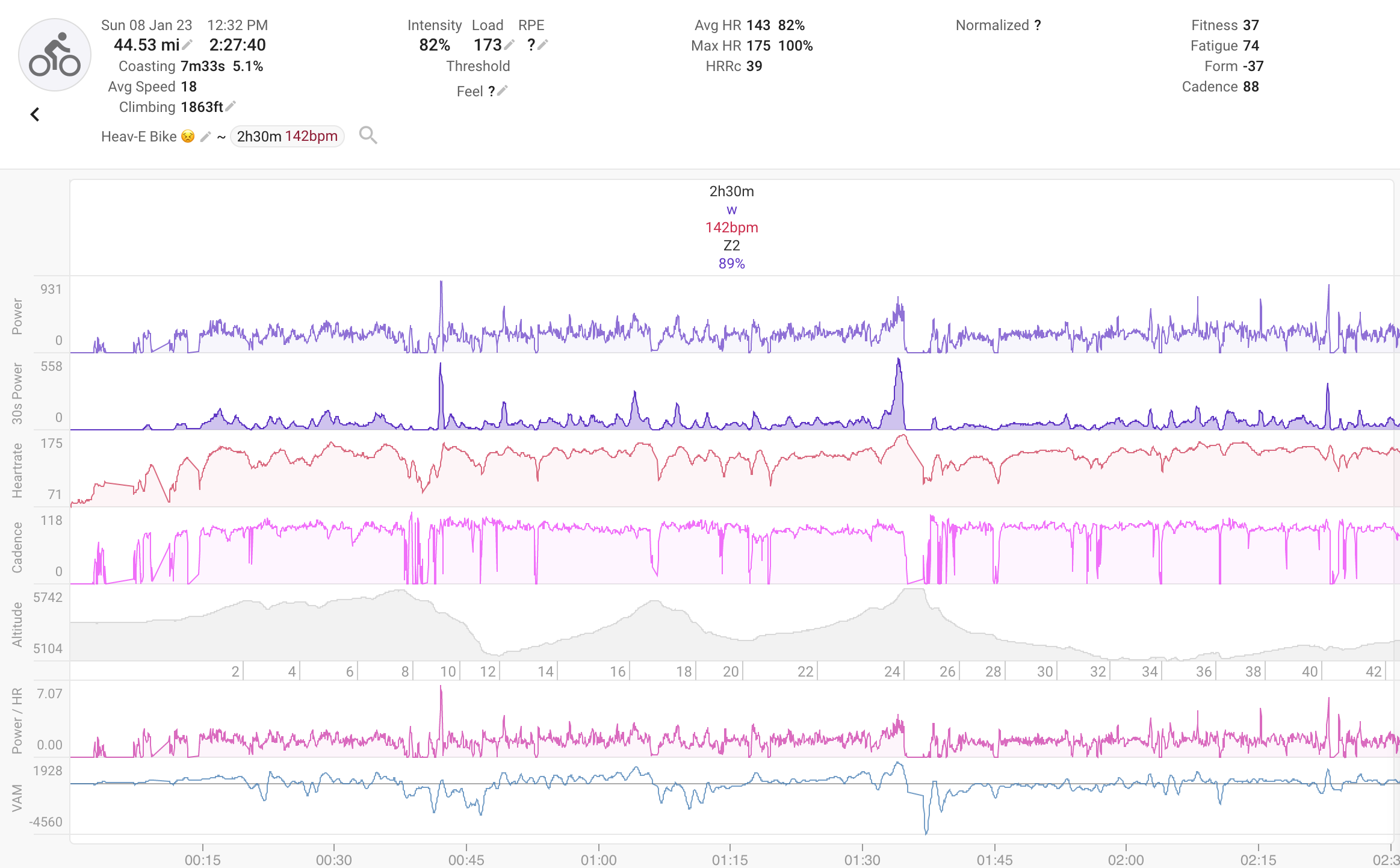

Activity recorded with a Wahoo ELEMNT Roam connected to my Creo SL, which has an internal power meter. I can see the power channel but for some reason there is no Power Analysis. Any ideas?

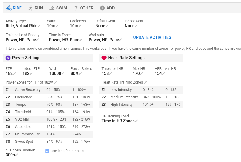

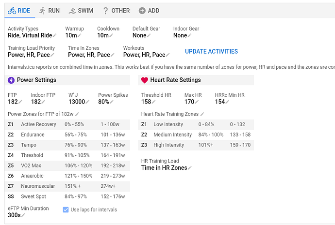

Did you configure FTP and Power Zones on the settings page? And if this is an E-Bike ride, did you check E-Bike ride as an Activity Type?

Did you change the workout or did you add E-Bike Ride to the sport ‘Ride’?
I was referring to the last option because if it is logged as an E-bike ride and E-bike ride is not part of any sport, the settings for Other will be used. By adding E-bike to the Ride sport, you make sure that it uses the settings for Ride.
I suspected the ride was logged as an E-bike ride because of the name :wink:
