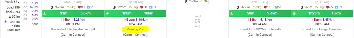

I have both Garmin and Strava connected to Intervals.icu. Usually, activities imported from both sources keep the Garmin name, which is my preference. However, sometimes an activity is assigned the Strava name, even though it is imported from Garmin, too.
Why is that, and is there a way to always keep the Garmin name?
Example:
Last week in Intervals.icu:
→ All activities carry the Garmin name, except the one on Tuesday (I might have done small changes on the names in Intervals.icu after import)

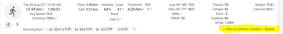

The Tuesday activity (link: Intervals.icu) is imported from both sources:
The fit file from Garmin does contain the original workout name:
The “keep non-Strava activities in sync” option is turned off, in case that matters:

It does not explain the one case in my example above though. This actually was a structured workout, and the name of the workout is included in the fit file which was sent to Intervals.icu (see screenshot from fitfileviewer above). Not sure if that is a singular case only - I will monitor if I see that more often…
