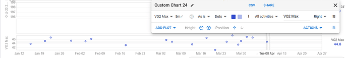

Just saw there’s a V02Max chart.
I am wondering how accurate is the estimation ?

it has been estimating my vo2 max at 57-59 over the past few weeks. I had a lab test done on a bike last week and it measured 64.
It would’ve been interesting to take your activity on Intervals and see what estimates intervals would have given.
