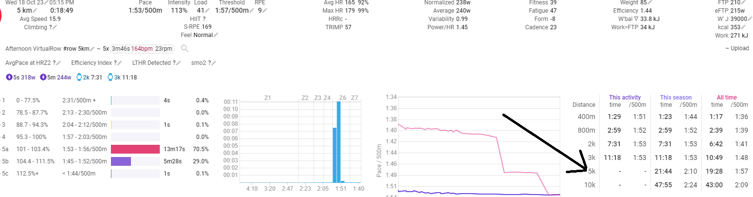

i have some Rowing Activity Intervals.icu
I did a 5km , is computed by Concept2 and Garmin , but when uploaded said 4.99km ( i dont know if this is the reason, and how to solve) I change to 5km trying to fix , but dont .
Any ideas?

NO, in the garmin and Concept2 - no problem! i tried uploaded with Garmin and COncept2 file , but both got the same error when uploaded to intervals.icu
i tried not use Garmin Watch to set distance etc… , because Garmin dont read distance only RPM , i use recorded with him “just in case” (plan B)

Yep , i use Fitfileviewer to see this I tried correct in many ways but only got me frustrated. I change the activity to 5km , but this dont reflect on my “race effort” Season , Pace profile - Any way to change that?
