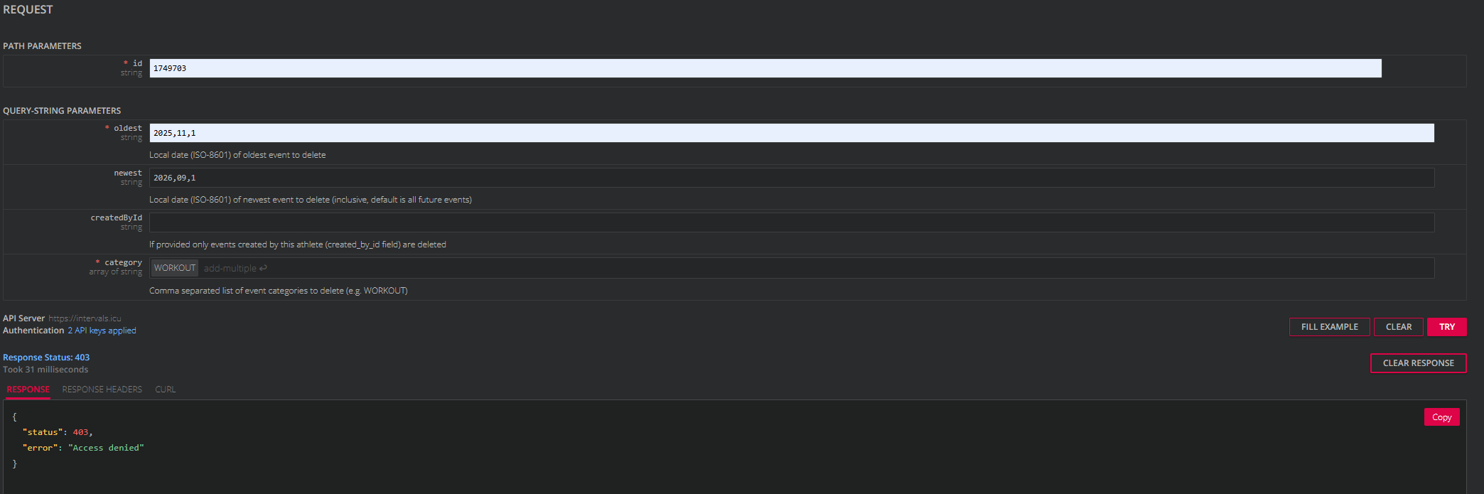

Trying to make a workout planner with python but having massive issues with a 403 error. Even in the API documentation when I try to delete workouts with the right user ID and date range, the error keeps coming back (both Auth methods used)
This first. Then here is the snippet I`m working on in Python:

Unfortunately always getting back a 403.. In Python I only used the bearer token.
You have to use basic auth. Username is literally ‘API_KEY’ and the password is your API key from the settings.
ITs set up like this:
USER = “API_KEY”
PASS = “my key, the long number”
ATHLETE_ID = “1749703”
BASE_URL = f"https://intervals.icu/api/v1/athlete/{ATHLETE_ID}"
AUTH = requests.auth.HTTPBasicAuth(PASS, “”)
But I only get a 403 back
That seems to be wrong. It’s probably
AUTH = requests.auth.HTTPBasicAuth(USER, PASS)
Got it working now, thanks a lot.
