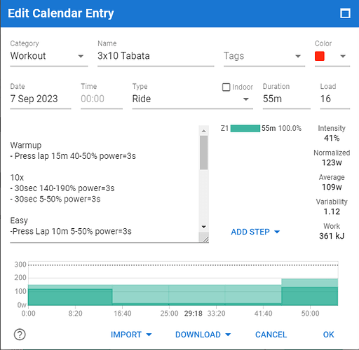

It looks like a few things are going on. First of all the load from the short 30 sec intervals is not being calculated and time in zone is not adding up. Also it seems like interval times listed in seconds is what might be breaking it? If I make the interval time 1min everything works fine. but if I make the interval time 60sec (or any other number of seconds higher or lower) it does not calculate and add up.
the workout:
Warmup
- Press lap 15m 40-50% power=3s
10x
- 30sec 140-190% power=3s
- 30sec 5-50% power=3s
Easy
-Press Lap 10m 5-50% power=3s
10x
Easy
10x
Easy
Cooldown
- 10m 45-65% power=3s
