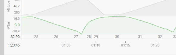

3 matches burned/efforts in the second half of the ride.
Maybe a need to re-assess your wBal number or your FTP.

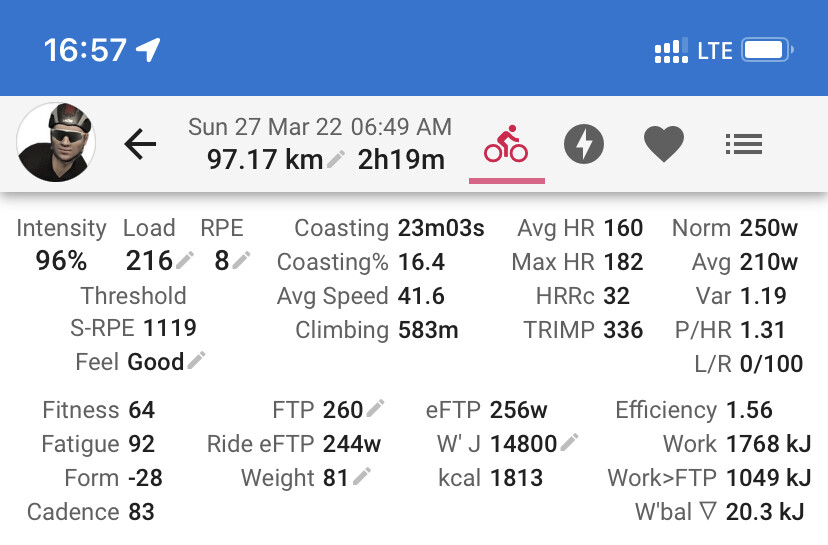

That was yesterdays FTP test. warm-up to the hill, 3 minute hard, then 2 x 8 minutes all out.
3 out of how many? ![]()
That’s what I did. It was my 1st FTP test this season, FTP/W’ was on 235/16K - now set to 250/18K
First time 2 x 8min FTP test… 286+282/2*0,9 = 255

Viewing the W’ graph, I think there was not much left in the tank ![]()
@MedTechCD right. As I said, I already adjusted FTP and W’
The FTP test showed me a higher FTP. I changed FTP within the activity but still was in negative W’. so i raised W’ till I got a zero at the lowest point. Is that the right way to go?
That’s how it showed up with the old values.
That will get you close enough. Did you reanalyse after the FTP change?
No need, changing numbers immediately affects the values/graphs after a reload.

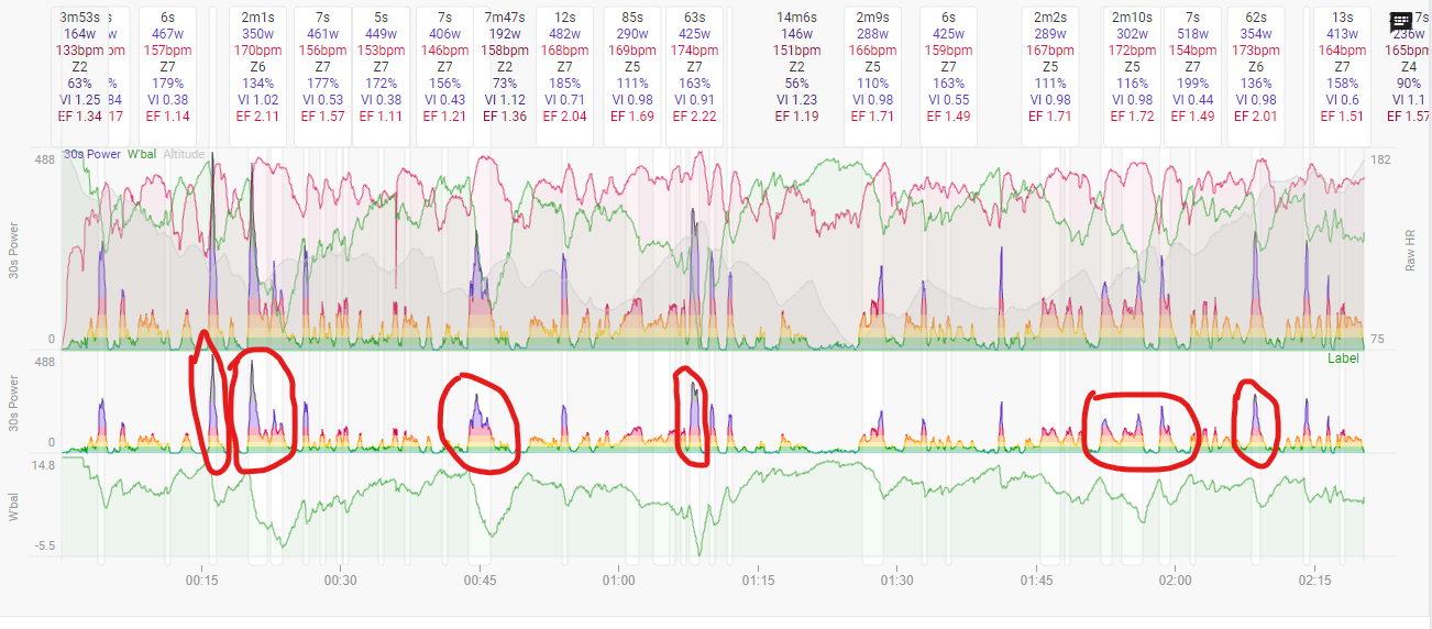

Not really burning fire. You don’t have much red, purple and black in your graph. So it’s more like simmer.
For the image below, when I look at WKO5’s Match Finder, I have 2 matches at 2xFTP, and the rest are at 1.4xFTP and 1.2xFTP. All the others that show purple peaks are not showing.
