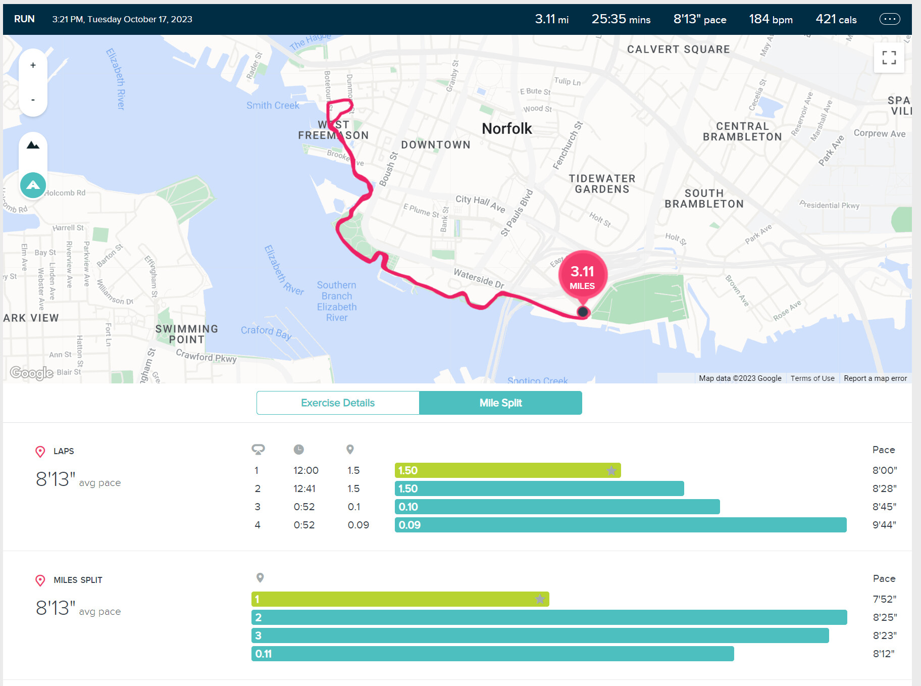

3.11mile run not showing up as 5k best PR
Just yesterday I ran my best 5k tracked on my Fitbit (with gps tracking) and when I uploaded it to intervals it does not track it as being a 5k. Any help would be greatly appreciated as this is super disheartening :frowning:

Ohhh okay, thank you so much for the reply! Now I know I’ll just aim for a little over my goal to make sure it counts it :grinning:
If you are using GAP in Intervals, try to use unmodified speed. You may be falling short a couple meters when displaying GAP results.
Oh okay, I think the GAP is the issue because it for some reason is saying I climbed like 600’sh ft when it was only 12ft. Thanks for spoting that!

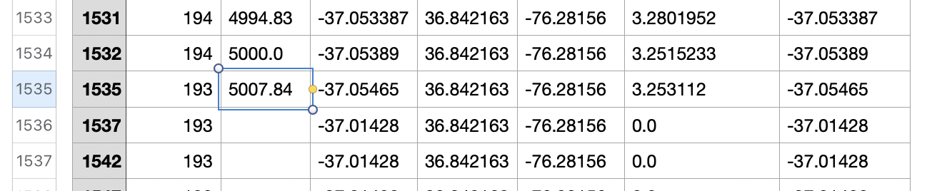

You actually did 5007m. There were a bunch of missing distance records at the and that was throwing out the best pace search. I added a workaround and your best 5k is now showing up.
