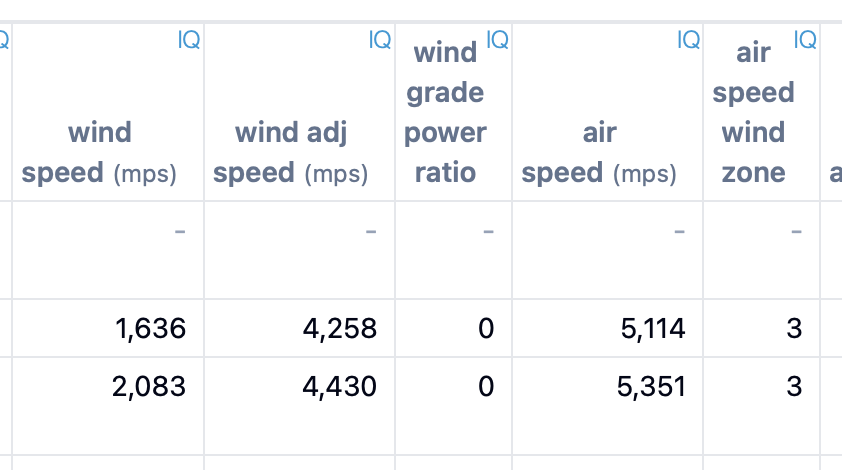

You can easily create custom activity streams to pickup those fields. Have a look at the record fields for the fit file for an activity (“Original Fit File” on the activity data tab) on fitfileviewer.com :
It says “mps” in the units but those values look like mps * 1000.

You will probably need to use some Javascript to convert to actual mps:
