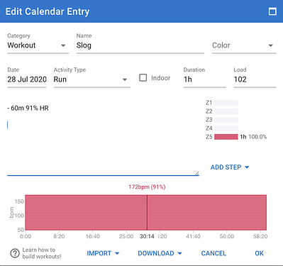

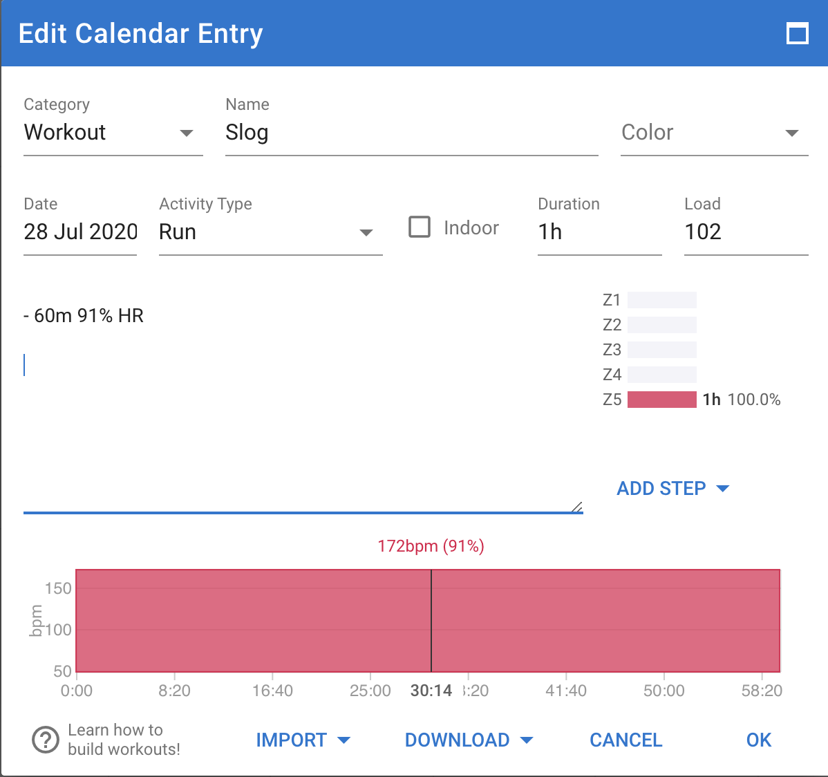

Found this bug when setting up my training plan in the calendar.
Unfortunately the workout builder doesn’t calculate training load for HR only steps yet. So when you edit the workout and add an extra character after the HR is sees that step as being for power as % of FTP and suddenly the workout has load.
I have just added support for calculating training load for HR based workouts using HRSS (normalised TRIMP). One hour at approx LTHR comes out at about 100 as you would expect.
If a step has power and HR then power is used to calculate load. If the workout has any steps with power then they should all have power to get an accurate load calculation.
