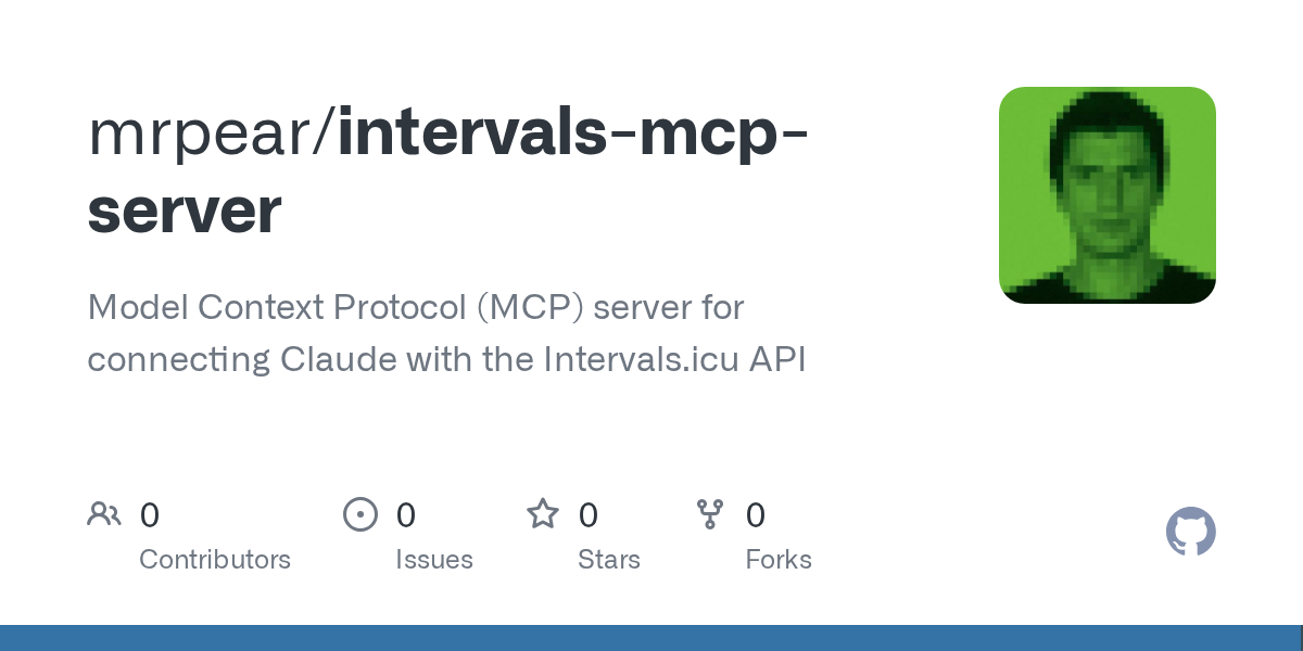

In the meantime I’m also trying to extend capabilities of Intervals MCP server, this is my fork of @Marc work but eventually I plan to merge it with upstream (WIP):
@mrpear Thanks, gravel/road is a great test bed, and nice work on the MCP fork.

Re the MCP fork: definitely relevant. I’m working on an MCP path for Section 11, too; just need to finish a couple of related pieces first.
