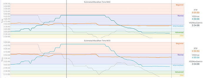

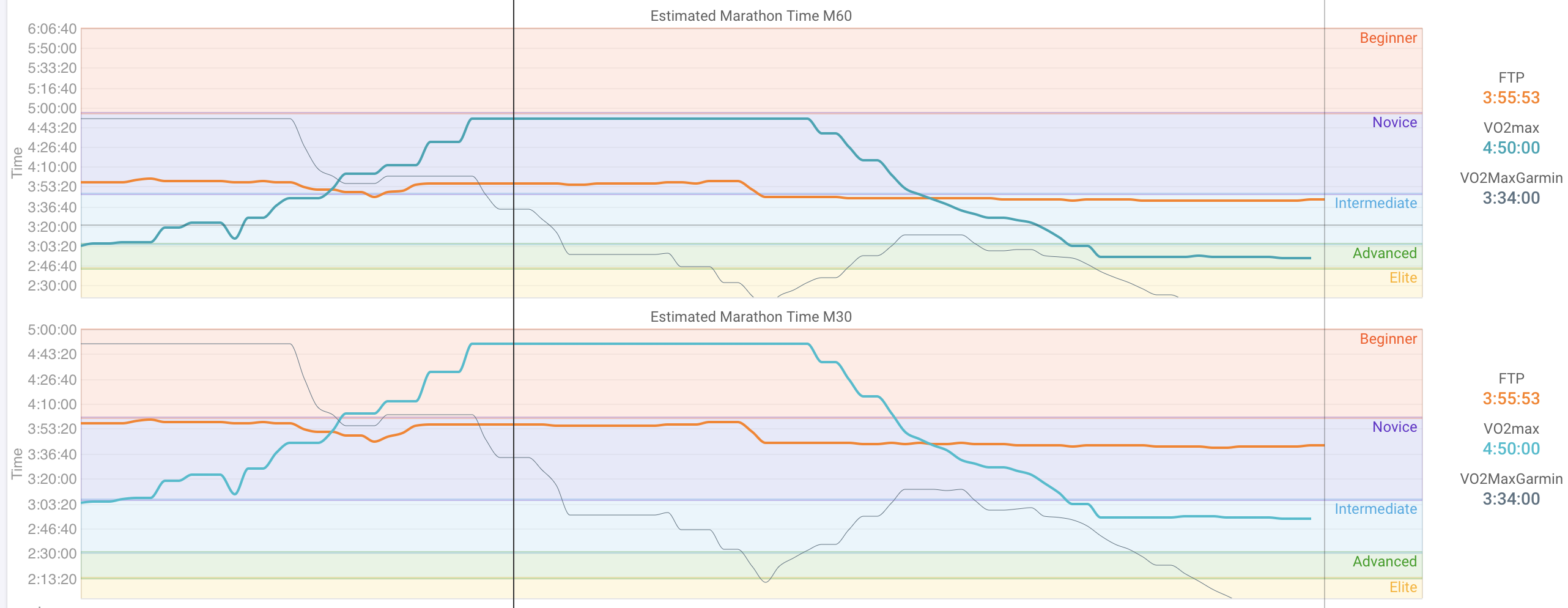

How did you create those charts?
I made the fitness diagrams public.
Search for “Estimated Marathon Time” (current M30, M60 , F30)
The activity field looks like:
ftp = Math.round(activity.icu_ftp)
percentage = 89
target_power = Math.round(ftp * percentage / 100)
distance = 42195
weight = activity.icu_weight
1.04*distance/(target_power/weight)
Is this a mathematical prediction based off a particular riegel exponent (1.04)?
just curious as if it is I would change the code for myself
The 1.04 is the specific energy consumption. And stands for energy consumption (in kiloJoules) per kilogram of body weight per kilometer. The unit is kJ/kg/km. In English literature you will find the term ECOR (Energy Cost of Running) for this specific energy consumption.
