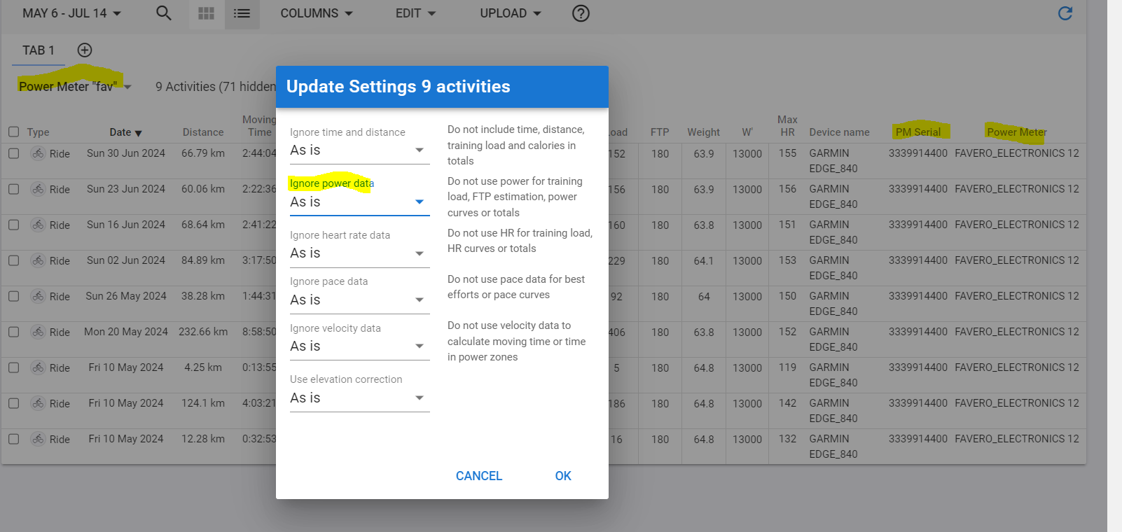

If you can filter the activities in the List View, use Edit - Update Settings - Ignore Power.
Possible filter could be PM serial number or Power Meter?? Or if you switched from Garmin to Stryd at a specific date, you can certainly filter by date.
Thanks.
I tried filtering by PM Serial, PM and Device name with no success.
Had to delve into the fit file to get the actual names/numbers used, but they don’t seem to be filtering by that.
Having the ability to filter by Power Field would be the best, as Intervals.icu seems to be prioritising based on that. Power for Stryd and power for Garmin.
