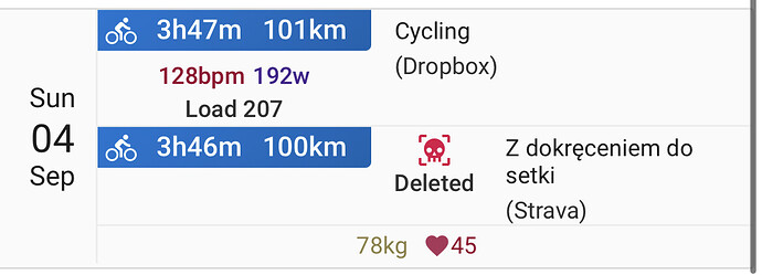

You can keep your Strava sync, intervals.icu is pretty clever and will just add missing data +like l/r balance) from your dropbox factivities.
is there a way to get my past activity from the wahoo cloud to the dropbox folder?
Hi!
As Łukasz said connect your Dropbox account. Next, in Intervals settings you can set “start_date” so all your activities from that date will be visible in Intervals.
You can also select “activity source” in the settings so you will see which is from STRAVA and which is from Dropbox
Of course with this step you don’t really need to sync all your data with STRAVA anymore.

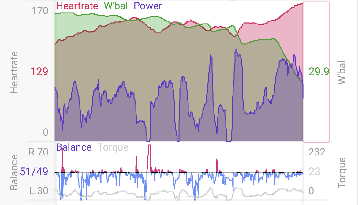

Here is my L/R balance graph. I have SRAM AXS
