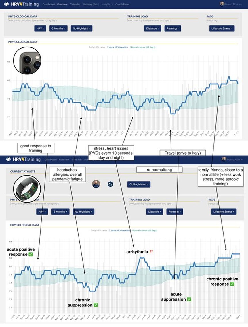

Oura performs better than watches: it doesn’t measure from the wrist, and it measures continuously throughout the night, whereas garmin and apple only take some random samples (which produce worthless data).
You forgot to quote this part:
Once again, if you like wearables, they can clearly capture high-quality HRV data as we sleep. Just make sure to use one that gives you the full night of data, as otherwise HRV measurements won’t be reliable (as I discuss in greater detail here). My recommendation would be the Oura ring for this exact reason: most other sensors will provide automatically collected sporadic data points (e.g. 5 minutes during the night, like the Apple Watch does), which unfortunately are noisy and do not reflect underlying physiological stress very well.
