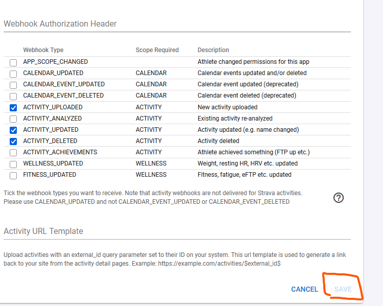

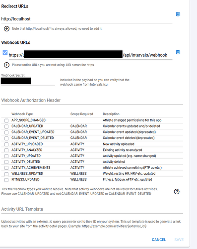

@david Hi David,
i have some problem with creating a webhook. I dont know why it does not work. But when i set Webhook Types, i can’t save them. If i enter for example a Webhook Authorization Header and Webhook Types i can save the form, but after refreshing the site the webhook types are gone.
The webhook URL is working, it’s a cloudflared tunnel to my localhost and i tried to reach it with curl from my server. But intervals.icu won’t send me webhooks, since the types are not saved i guess?
Yet another bug introduced by the big update. Fixed. Tx for the report.
thank you for the fast fix. Working as expected now.
