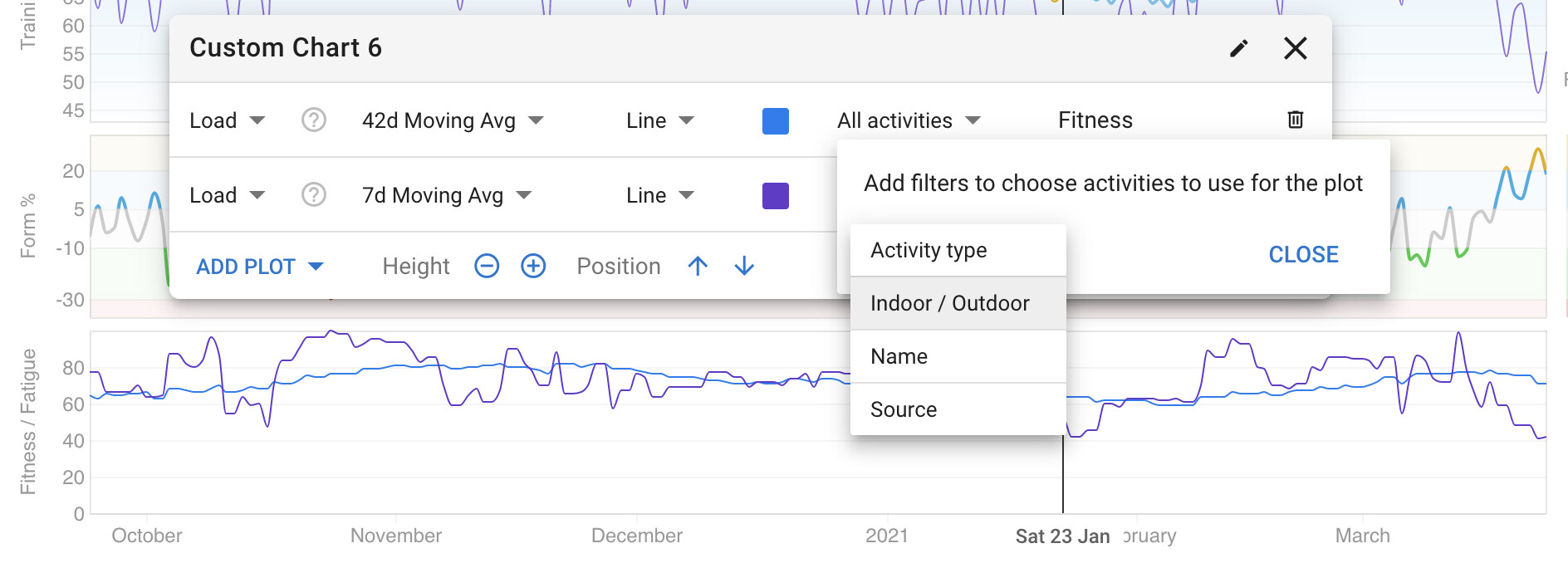

Is possible to separate indoor/outdoor activities on the fitness tab? Similar to the Power Curves dropdown on the the power tab. I have some inconsistency between indoor trainer power and outdoor PM and while I’m happy to live with that it would be good to view how things are progressing in each mode. I have, just, set different FTPs for indoor and outdoor. Apologies if this is a dumb thing to ask.
It has been asked a few times. Unfortunately it’s quite hard to implement. The running 42d and 7d load fields are pre-computed and stored on each activity and that is what is displayed on that chart and elsewhere.

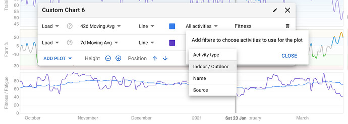

However you can add a custom chart to compute them on the fly:

Yes I thought there might some catches in what I was asking. I was looking for a way to overcome the differences between the actual power numbers indoor v outdoor. I will try the custom chart option. :smile:
