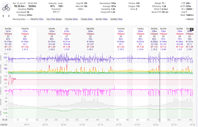

My HR is display without problems in Golden Cheetah but when I export the fit file it misses a lot of it.
Any ideas?

I opened the fit file for that ride in https://www.fitfileviewer.com and most of the HR data is 152 bpm as shown on the chart.

Garmin FR 920xt
When it failed to import properly from Strava, I deleted it and then imported it to Golden C by usb - only the bike and run.
Then I checked to see if they were ok and expoted to .fit.
Finally I imported them to intervals.
So was the original file from the device not a .fit file? (gpx maybe?).
