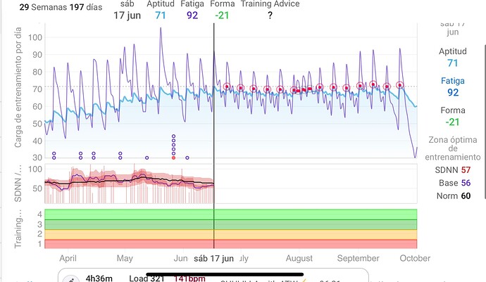

Porque mi grafico no tiene anotaciones??? Que tengo que modificar??
Check line 13, in the config_athletes.m file:
Must be set to “true”
Check your wellness data, to see if you have Training Advice showing. If it’s not there, you must add it in wellness data.

Line 13, when true, writes the training advice to the wellness data as a score of 1, 2, 3 or 4.
The graph/chart on the fitness page tracks the values every day, using the values 1-4.
Do you see Training Advice in the wellness data?

Ahora si lo veo, pero solo el de hoy
Es posible ver los dias anteriores??
  1. Use the file PopulateImReady4.m
  2. Select as many days as you have data.

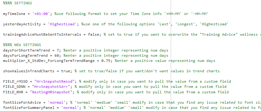

I have recently switched to measuring my morning HRV with Garmin´s Heatlh Snapshot instead of HRV4 Trainning. I can see and plot the readings of RHR, RMSSD and SDRR from the snapshot as fields on intervals (HrvSnapshotSdrr HrvSnapshotRmssd and RestingHRSnapshot), but Imready4 seems to pick my avg. night RHR and avg. night RMSSD to provide the training recommendation. Could anyone give some guidance on what to update on the code to get Imready4 to advise based on HrvSnapshotSdrr HrvSnapshotRmssd and RestingHRSnapshot?
Lines 21-24 in your config_athletes.m file.
Enter the names of the fields you want to use
Thank you for the quick response. I had an old version of config_athletes.m. I have updated the fields, but still getting the default values plotted. Am I missing something here?

From your screenshot I would think the naming of the fields is correct but you better double check.
The name and the internally used code are not the same. Capital letters are important!

Thank you, I have tried using PopulateImReady4 but the problem persisted. What I have done, is update the field values on ImReady4.m and PopulateImReady4 as follows, and seems to work.
It no longer plots the previous HRV data, but I will import it to Intervals so it is all under the fields that I want to use from now on.
