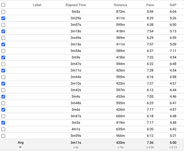

GAP is too much faster for all of my runs

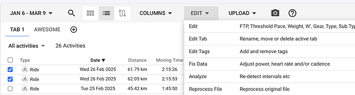

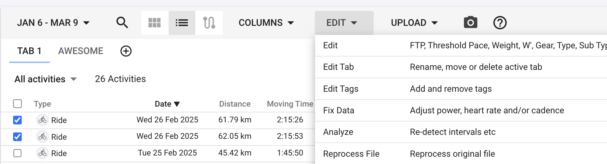

did you try usinbg the list view and do a filter for Runs?
I am encountering the same problem and my settings for Elevation Correction have always been “No”, and GAP Model from Strava run.

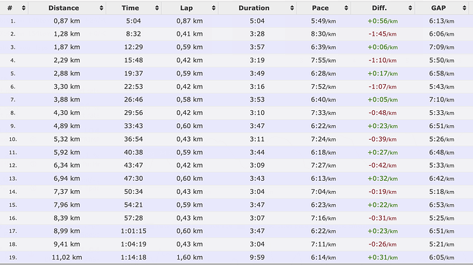

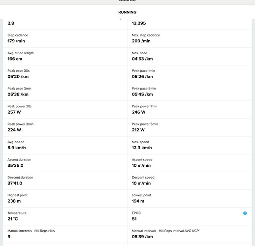

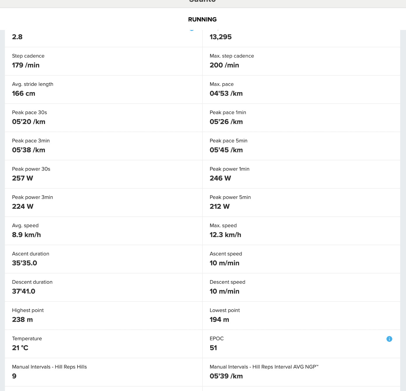

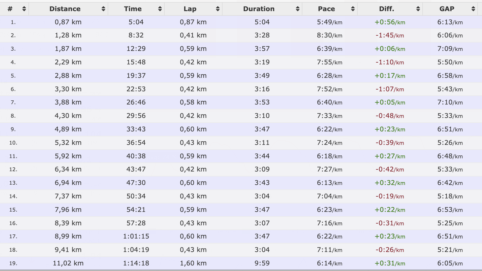

My run is not flat, it contains laps on a hill. Runalyse and Suunto App, or the Suunto watch itself during the activity, show a totally different GAP (for each individual lap, and obviously as an average) than intervals.
Ah, I’m having the same problem with GAP in Intervals. No elevation correction, reprocessed. Just concerned that it affects the Load number as it determines Fitness line graph.
While in Runalyze, Pace & GAP are near identical as they should be since there’s almost no gradient.
