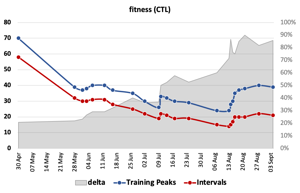

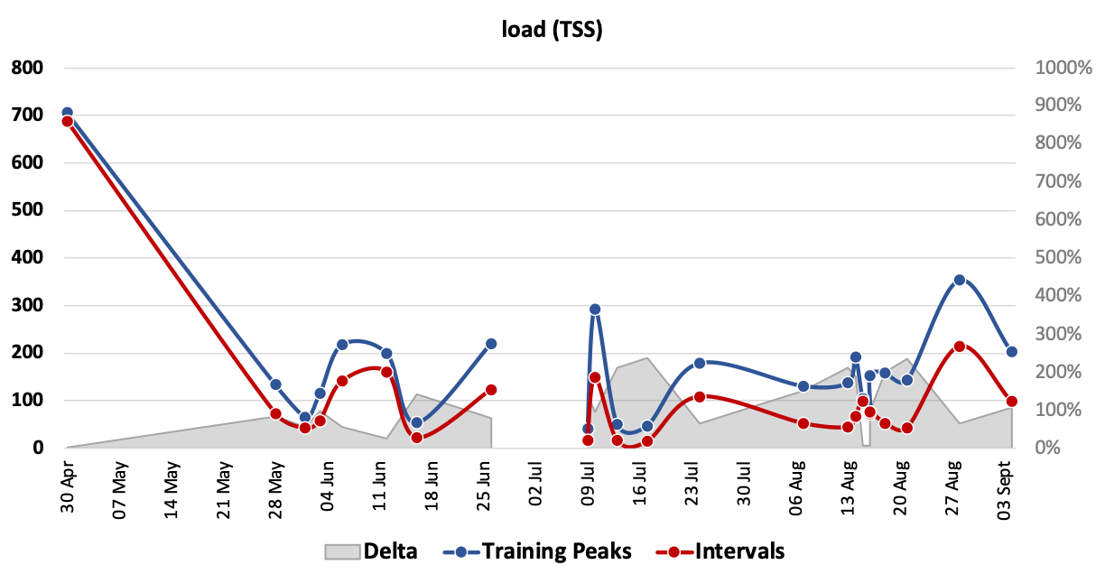

Here are the original Excel charts updated for the corrected TSS (there is still something weird about my CTL in Intervals…):

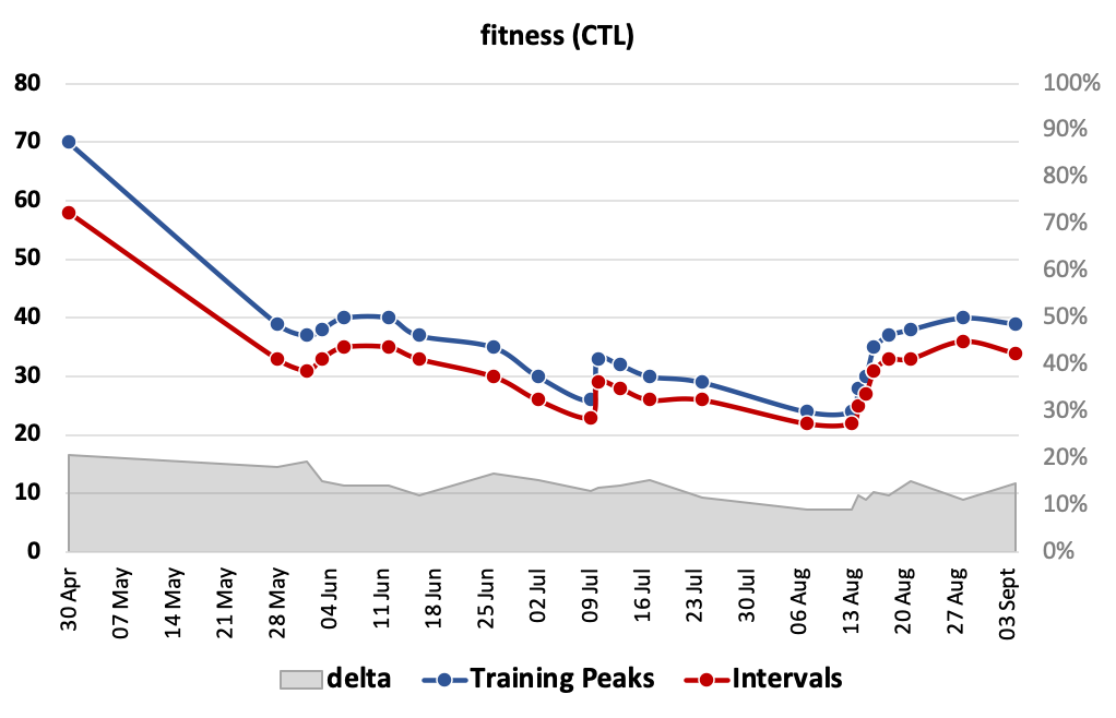

This was before the problem was solved:
And this is now:
