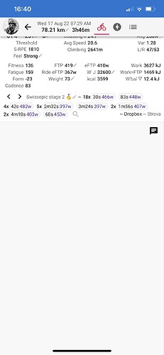

Did not see any graphs
Hey, since some days I had this problem that I didn’t see any graphic anymore. Can someone help me?

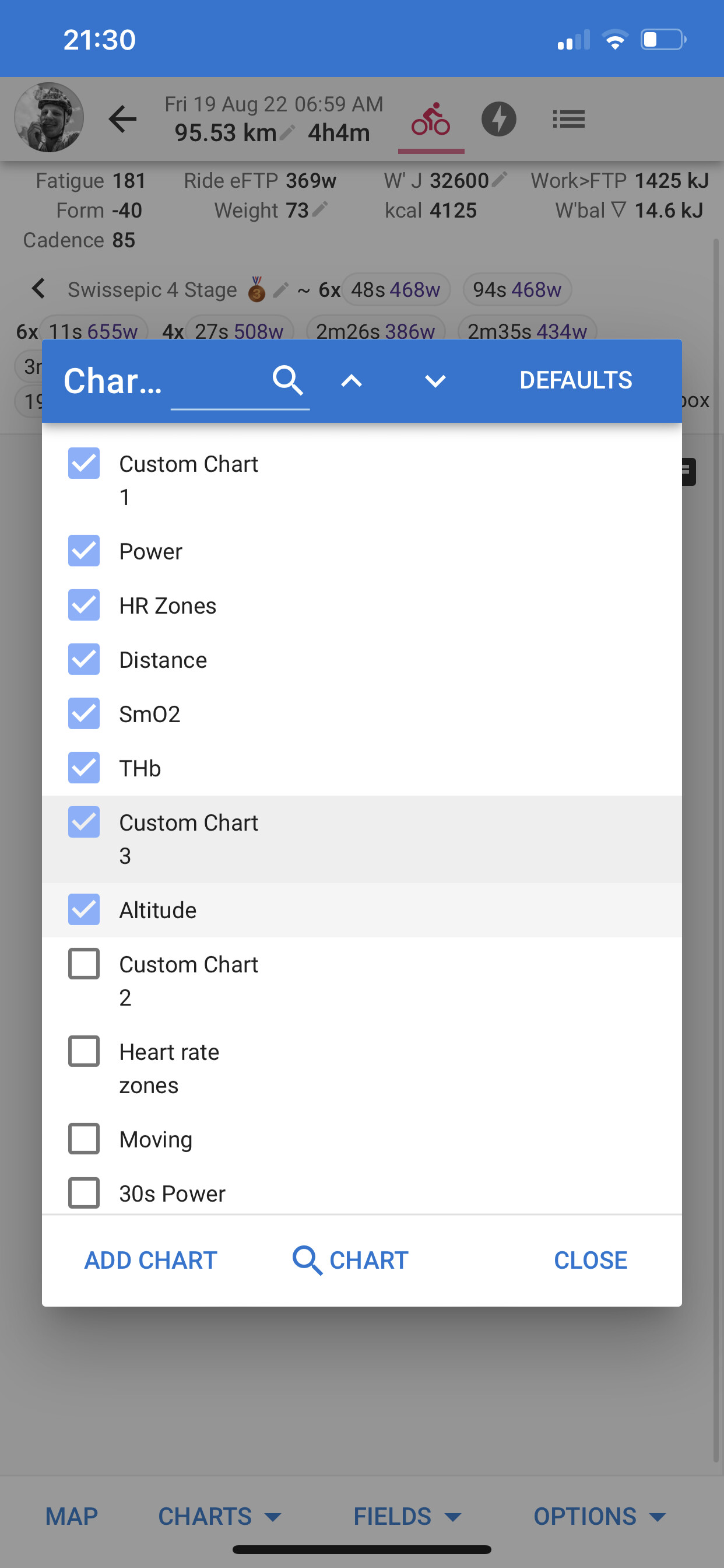

Click the “Charts” button and check which ones are ticked. I just had a look at that activity and I can see normal charts. What browser/device are you using?
Yes looks normal
I use IOS, also on my iPad I have the same problem since 2-3 days
This is fixed now. Custom charts were broken for charts with a plot with line opacity zero and area opacity not zero. Sorry about that. Tx for the report. Good luck for the rest of race!
Ok, I understand. Thanks for repair and this great platform. I really appreciate.
