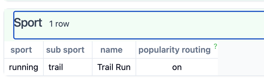

You can confirm this by downloading the Original FIT file from your Wahoo Unit, then putting it into fitfileviewer.com and looking at the subtype (if it exists)
eg: A Trail Run I did. if your headunit/watch does not have the subsport, it would only be known as a RUN type and won’t get classified as a Trail Run. You’ll have to manually change it at whichever site you uploaded it to.

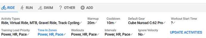

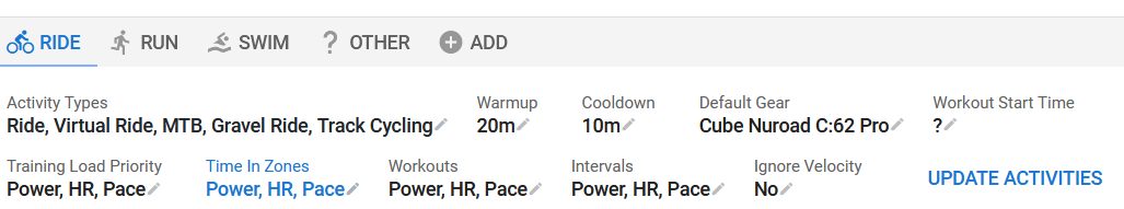

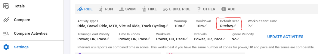

In your Intervals /Settings, what does your default bike setup look like?
You mention it in your OP, but is it setup like that?
