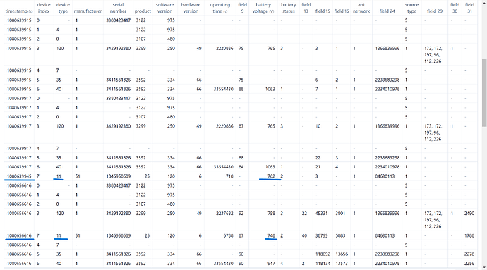

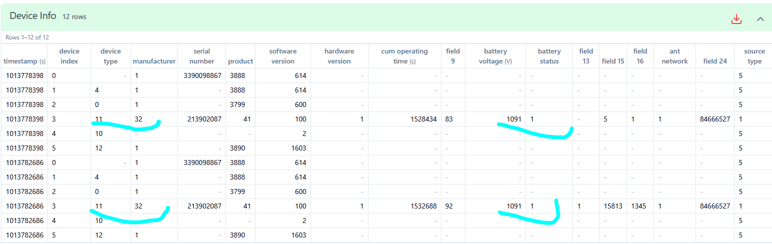

Its not possible, in fit file power meter’s voltage at the start of the ride and at the end have the same value.
At least there is a field for that. Perhaps in future.

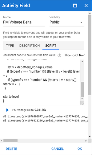

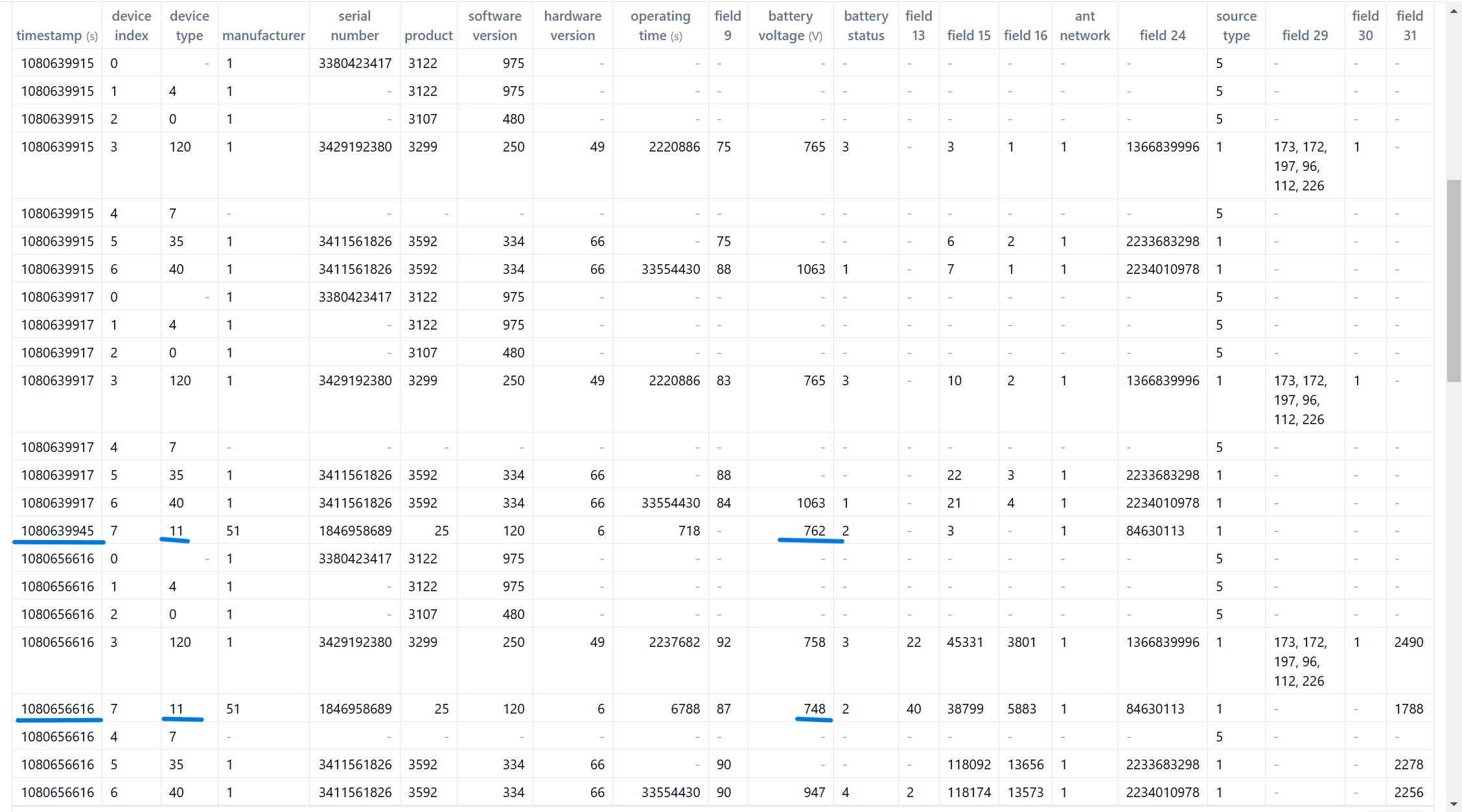

Thanks, Pepe. The fit file I’m looking at is showing different voltage figures at the start and end timestamps, which is what got me thinking in the first place about grabbing the last row for the device type rather than the first. Perhaps your PM battery has slower drain rate than the one I happened to have been using for the ride in this file (4iiii).

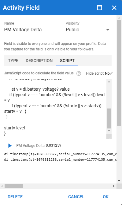

Please try now
and the delta
@jspira Thanks for asking, because I hadn’t realized that’s what my script was pulling out. Here’s an updated version of my script that pulls the last recorded voltage:
