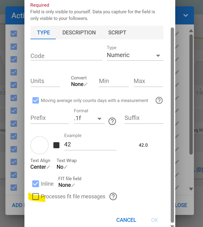

You need to tick the ā€œProcessed fit file messagesā€ box and use a script:

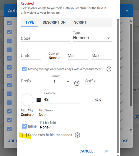

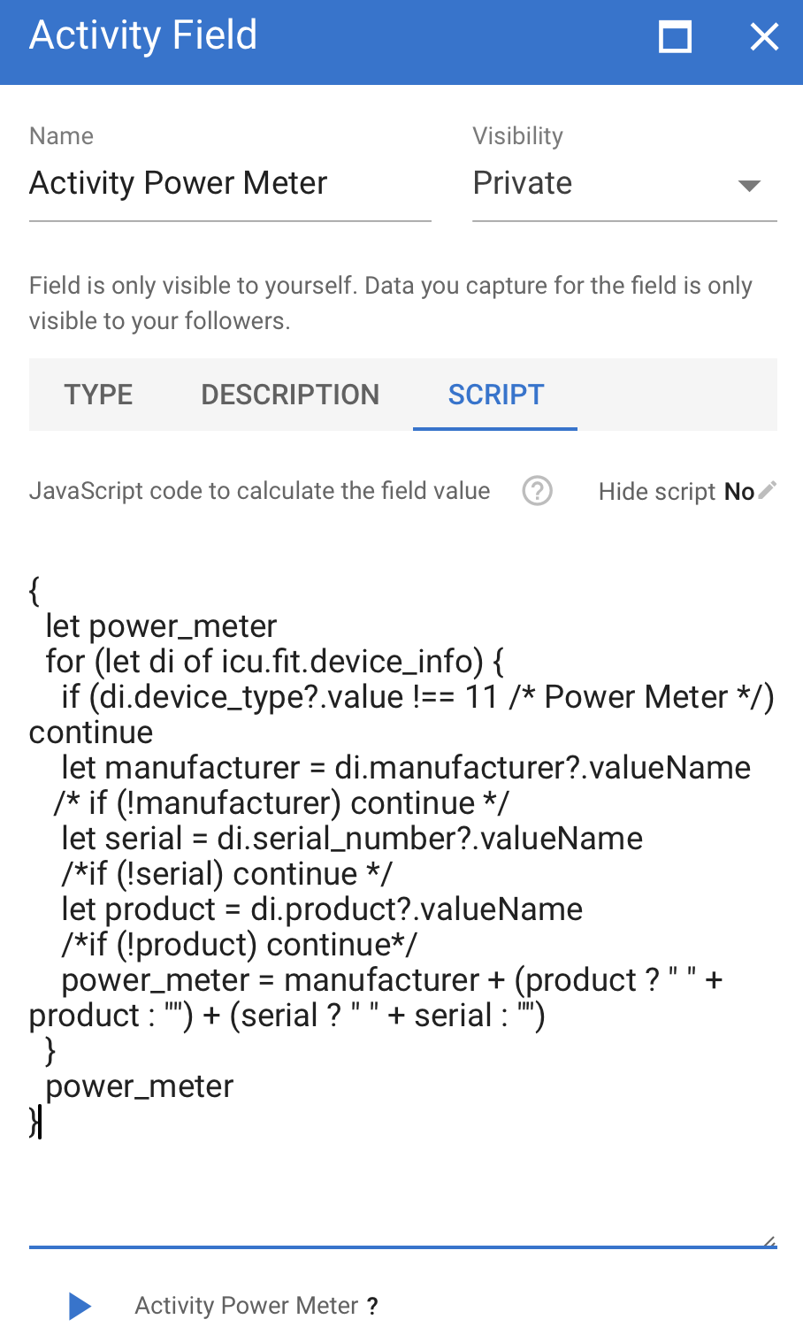

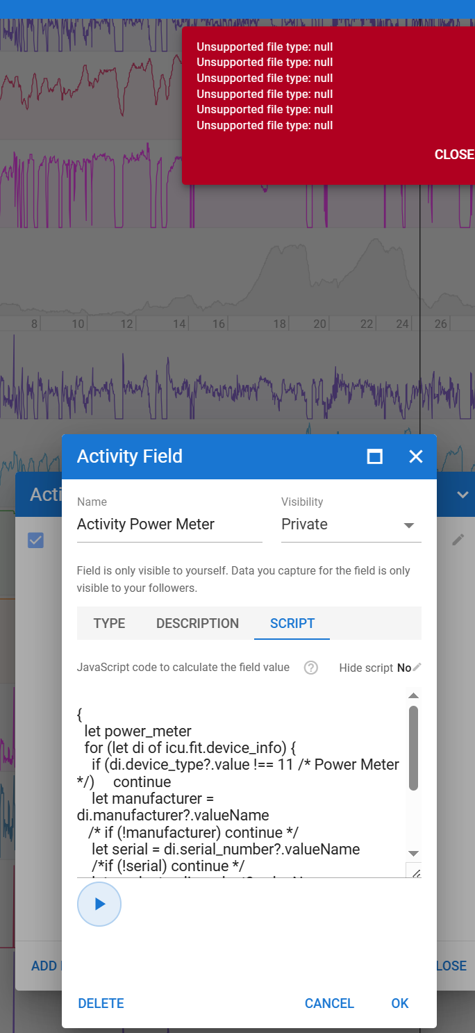

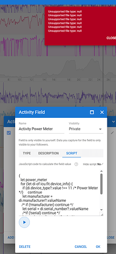

I am having trouble using the Activity Power Meter custom activity field.
I get the error ā€œUnsupported file type: nullā€
I’ve tried other custom fields and I get the same issue.
I’m definitely using a fit file:
2025-08-07-053647-ELEMNT_BOLT_B8E9-53-020250807-47707-hvjk80.fit
Is there anything obvious I’m missing?
Did you check the ā€˜Processes Fit File messages’ box?
Yes I have the ā€˜Processes Fit File messages’ checked

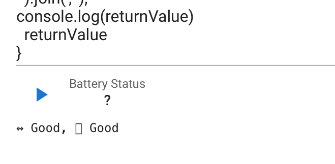

@david @eva

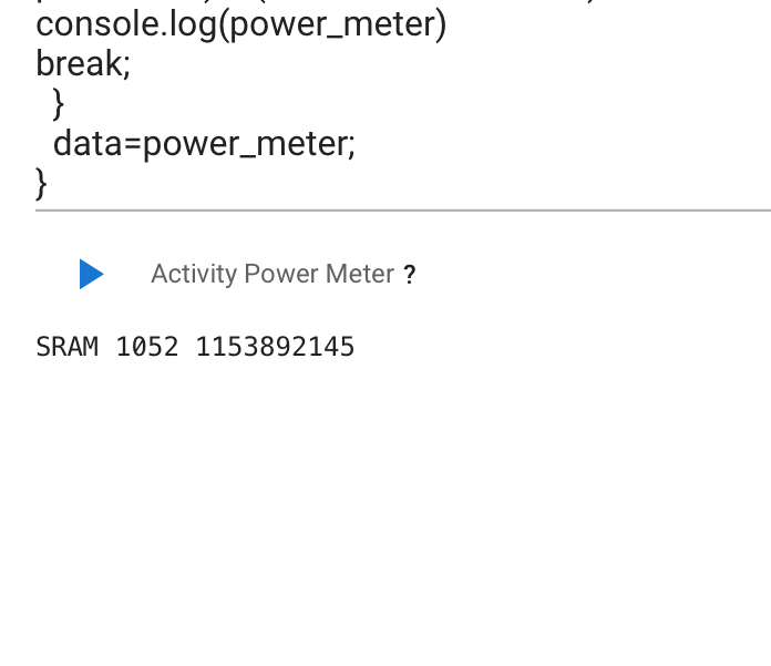

I think there must be another bug with processing fit files and writing these as string.
Old variables are working:
But if I press the play button it doesn’t work. And it doesn’t work with newly added field neither, like OP said:
I am using this field. and when I press ā€œPLAYā€ nothing comes out except what you see below screenshot.
weird thing is -
I am actually getting the correct value/data
Screenshot 2025-08-12 at 3.27.08 PM

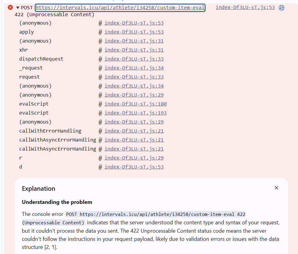

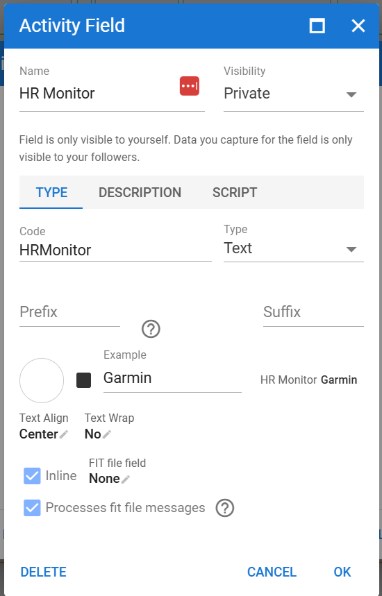

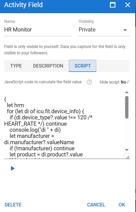

I’ve even tried @david 's HR Monitor activity field and I’m getting the error:
I’m using a Wahoo ELEMNT Bolt 3 and the fit file
This is error I get in the browser:
This is fixed now, tx for the report.
Your activities are from the Strava API and Strava doesn’t hand over the original files. So there is no fit file to process. We will fix that error message.
You should connect your Wahoo directly so Intervals.icu gets the fit file. Keep Strava connected so the two are linked. You can use the ā€œImport All Strava dataā€ button in the Strava box in /settings to get original files for all of your Strava stuff.
